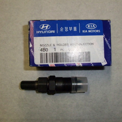

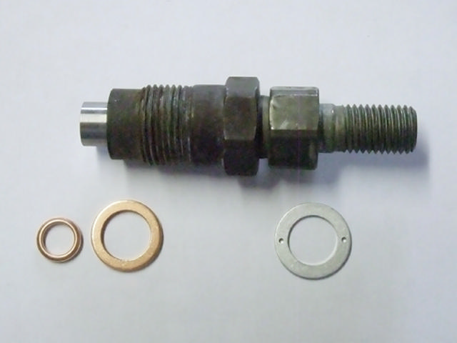

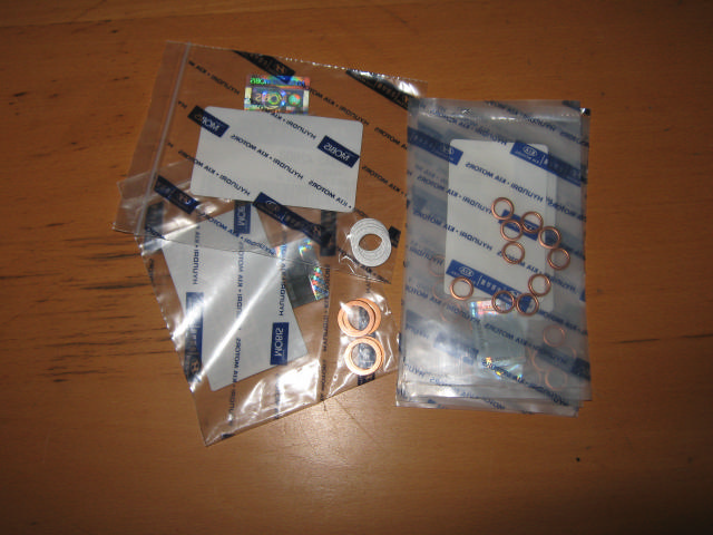

Hi Mardy,
Can you tell me why Korean nozzles for 4D56 won’t fit 4M40?
It would be appreciated if you give us a concrete background.
We have a non-turbo-use, turbo-use and intercooler-turbo-use in stock from Hyundai Mobis.
No offense anyway, just curious.
Steven

Nice product pictures. Not really related to transmission but okay.Rising Sun Auto Import wrote:Can you tell me why Korean nozzles for 4D56 won’t fit 4M40?
Quality between an OEM manufactured product and an aftermarket Chinese/Korean product.
The material v-groove in the nozzle is different between Japan (OEM), Korean (aftermarket) and Chinese (aftermarket) because of the tooling process.
The same goes for many other JDM's. I have a set of Korean nozzle tips (paid $20 each) for a TD42 and you can visually tell the difference between the original Japanese nozzle tips (paid $95 each).
The reason people buy aftermarket tooled products comes down to two things : cost and availability.
Simply put, you get what you pay for and it comes down to whether you want to pay for Japanese or Chinese or Korean tooled products.
Don't knock used OEM nozzle tips. They are tough and take a good cleaning if done properly and the cracking pressure/spray pattern is set right. CVI are experts on this.
