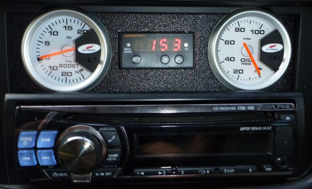

So here's what I finally got mounted in my van. Auber Pyrometer with an Autometer EGT probe (installed in the exhaust manifold not the EGR blanking plate). Boost and Oil Pressure Gauges from Harbor Freight in the US. Bad sending unit on the Oil Pressure Gauge. Have to replace that to get it working. What do you expect for $25?
Thanks for the great work Laurentiu.

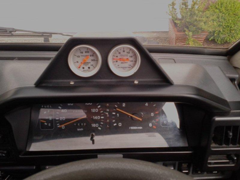

Re: Pyro and Boost gauge - what kind and where did you mount
Well, I can finally respond to my own post that I started some time ago.  It took me long enough, but I now have a boost gauge and pyrometer installed in the Delica.  Sorry about the crappy cell phone photos.  I'll try and swap them out with photos taken with a real camera sometime.
What I did was pick up some Autometer Sport Comp II gauges and attach them to the steering column via the narrowest dual gauge pod I could find...the adjustable Perrin Performance one. One issue I ran into was that the gauges would reflect onto the windshield...doh! So, back onto eBay I went and found two gauge hoods. I was hoping for deeper gauge hoods, however I was able to get these ones to work by tilting the gauge pod towards the driver (3 spacers on the back bolt and no spacers on the front bolts). I'm quite pleased with the install. Because these pods are adjustable, I was able to get them to not block any of the instrument lights or gauges.
Aaron
Aaron
Nice knees.
Arron TM, I like your arrangement, right in the control zone. Are you thinking of putting some sort of housing around the rear parts of the gauges?

That boost gauge is it a compound gauge ie shows vacuum as well

Haha, thanks Falco. Unfortunately, that pod is in fact open at the back, as you noticed. I may add something to the back one day, but you don't see any wiring from the drivers position...so, I am in no rush.FalcoColumbarius wrote:Nice knees.

It is a boost and vacuum gauge, similar to the one I put in my car several years ago. Unlike the gas powered car, the diesel never dips into the vacuum part of the gauge.legionnair wrote:That boost gauge is it a compound gauge ie shows vacuum as well
