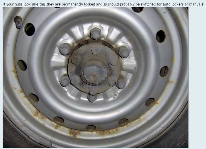

Hawkdrver- I think if you take the cover off your front hub you will find you have the permanent type hub like the one below. Vans with the Auto hubs have the center cut out of the cover which show the auto hub. ( At least it looked that way to me from your original picture) I borrowed the picture from a previous post Konadog used when he changed to manual hubs. Permanent hubs, as you are aware, run all you front end drive system all the time.
I guess the good part of that is you can switch into 4 wheel drive @ any time and you are sure your hubs are engaged!!

Re: Manual hubs for a l300
See, now this is what makes this forum awesome. I was wondering whether what you mentioned was indeed the case. With that additional fact, it now makes perfect sense to get manual hubs. Thanks!lrp374 wrote:Hawkdrver- I think if you take the cover off your front hub you will find you have the permanent type hub like the one below. Vans with the Auto hubs have the center cut out of the cover which show the auto hub. ( At least it looked that way to me from your original picture) I borrowed the picture from a previous post Konadog used when he changed to manual hubs. Permanent hubs, as you are aware, run all you front end drive system all the time.
