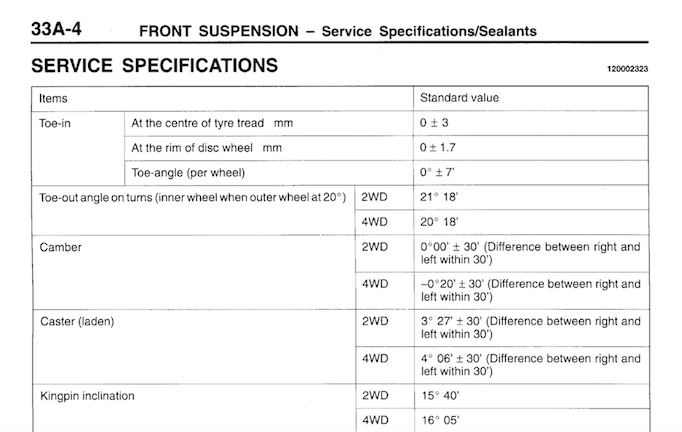

I order 4 new Duratrac tire and I would like to do an alignment on the same time. The problem is that they don't have the toe, camber ect.. and information that they need for a alignment. I tried to find it no success. Somebody know where I can find it??

I found this on one of several responses to a search. Seems to be a lot of info out there.
The official Mitsubishi data is as follows:
Camber: 0º30’ ±45’
Castor: 3º±1º
Toe-in (at wheel rim): 0-3
Toe-in (per wheel): ±8’
Also found a PDF with all the info here:
http://www.delica.ca/manuals/L-400%20Ma ... ENSION.pdf
Here is a screen shot of the appropriate specs in case you have trouble accessing the PDF.
Screen Shot 2015-07-13 at 11.20.02 AM.png (125.26 KiB) Viewed 3590 times
Hope this helps

Thank you!! I also looked in the delica.ca but I the wrong place. Thank you It gonna help the mechanic.
