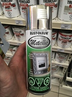

Funny you should ask...YES! I had the exact same problem with one of mine. I did manage to pry it all apart and then I just sprayed it with a paint bomb of chrome. I think I got it at Canadian Tire in the paint department. It has held up for a year now, surprisingly (I didn't have much confidence as it is not an automotive quality paint...)

Canadian Tire:
Chrome paint.jpg (36.1 KiB) Viewed 5982 times
