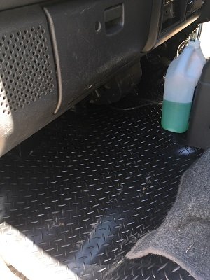

I have no advice for the leaks but I have always wondered,"Why do they put carpet in a vehicle?"...
I'm planning on pulling the carpet out of my cockpit and putting in rubber flooring. Princess Auto had a sale on rubber flooring a few weeks ago so for a $25 investment I got 5ft of it (4ft wide which should cover it). I'll post photos when I get to it....

Actually that sounds like an excellent idea!! Carpet is not very practical in vehicles. I tried to find rubber floor mats for our L300's, but had no luck in my search . Apparently they did make them for our van's, but they're very hard to find. I love the Weather Tech Floor Mats, but obviously they don't make them for our vans.
I'm curious to see how yours turns out. Please do post pics when you've got the rubber installed.

Just finished up. Posted the full project in "What did you do TO ..."

The rubber mats look great, and will be far more functional I'm sure.

Gotta say the mats do smell, kinda like cheap cigars. It was a warm day and, well, I’m hoping it off gasses quickly or I’ll be installing Mat2.0...
