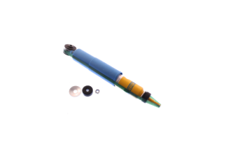

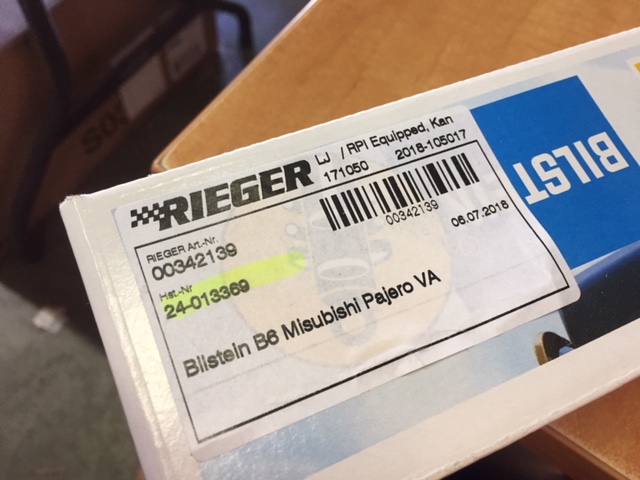

I like them but would like to give Bilstein a try. Finding a proper part number for the fronts seems to be easy, the rears are a different story. So I contacted Bilstein directly with the collapsed and expanded measurements of my Pro Comps.
This is what they emailed me back with.
Fronts: 24-013369 For a 89-91 Montero. 13.9 ext and 8.86 col
bilstein front.png (15.33 KiB) Viewed 10584 times
Rear 24-022156 18.8 ext and 12.26 col. eye top has a 12.3mm hardware sleeve. It is intended for a 95-04 Range Rover rear

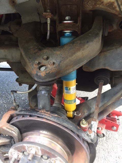

Well... A month later I got the fronts (they had to be backordered from Germany). Installed in about an hour each side. First impressions: Stiff!
The ride is still harsh and jarring over bumps but the handling seems to be much more controlled after replacing the shocks. A lot less nose dive now going slow over speed bumps.
I think I had some delusions of never feeling these dash shaking bumps again....I have to remember I'm driving an old cab over engine bus. The Bilsteins did level out the van nicely as the front was beginning to sag a bit. I don't have a lift kit.
Not sure I'll get the Bilstein rears. Maybe just save some money and get Pro Comp's again.
