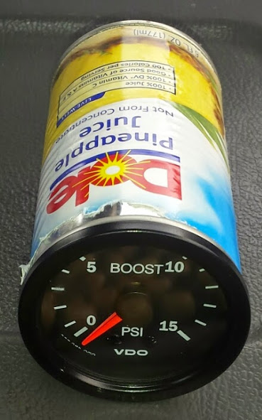

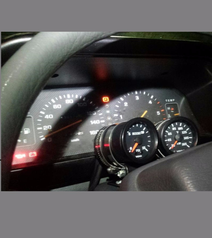

I installed a pyro along with a boost gauge right before I headed to Colorado from South Carolina (and I'm glad I did!) It's amazing how quickly those temps can rise when you're not paying attention to your pedal pressure or incline.
The two gauges were VDO from summit racing. I liked the style and location I found here http://dinoevo.de/pyrometer-boost-gauge/ so I replicated it for the most part.
I didn't really feel like paying $80 something for the housing pods and was lucky enough to find that Dole pineapple juice cans are the perfect fit once the length is trimmed. Those, rattle canned black, attached with hose clamps to cold forged aluminum bars, which in turn were screwed into the steering column cover, IMHO provided a utilitarian look at a modest price of around $10.
I had already blanked my EGR so I just took the steel plate to a machinist and had him drill and tap it to place the pyro probe in. Also for you Falco, I used the old EGR gasket on the blanking plate and it seems to be working well.
Hope that helps and good luck with the install.
