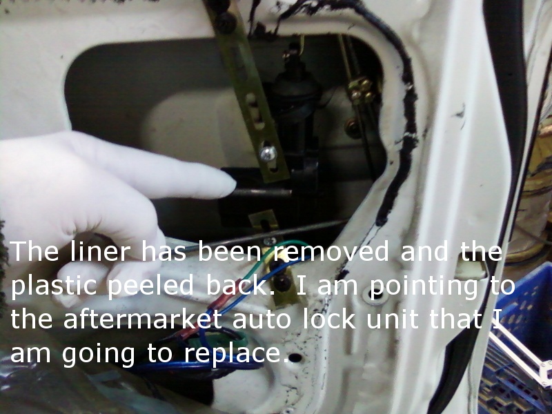

Re: Replacing front drivers side window
Hey G-man.
on the door, on the inside there are 4 bolts. The 2 on the right are the ones I removed.
This allows the scissor lift 'system' to be moveable, and will allow you to first get the wheel on the left into the track on the window, and then you just have to fiddle with the wheel/roller on the right to get it to line up and slide into the track. Once the rollers are in the track, then you can put the far right bolts back on.....
As soon as i removed those right side bolts, it was pretty obvious how to get the rollers and tracks to line up...but before that, I was cussing and swearing trying to find some secret/magic way of getting the rollers and track to engage.
In this pic, the bolts would be right around where the word "am" in "am going to replace." is located...
