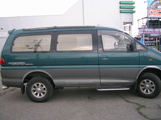

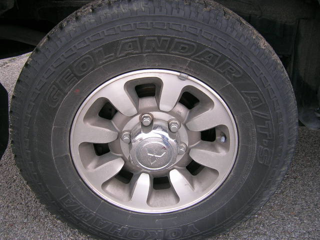

I can tell you it has stock rims...
And it appears that the springs are ok...
But Starbug has not arrived yet! I am trying to decide if I should just get bigger tires right out of the gate.
- Looks to be ok for height....
- DSCN0707.JPG (82.42 KiB) Viewed 7824 times
- Stock Rims
- DSCN0740.JPG (83.43 KiB) Viewed 7826 times
Re: Tire Sizes for L400
235/75/15
or around a 29.5" maximum radius tire and no wider than 9.5"
If larger you'll need trimming
Will depend on wheel offset as well but with the stock rims that you have, 235/75/15 is the best size
