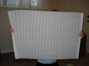

Then we cut them to 22"
Sandy cutting the RediShade to 22"

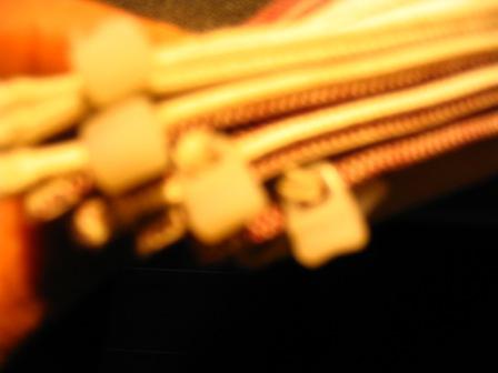

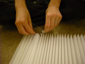

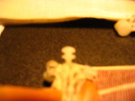

Sandy sewing on the plastic sliders.
Sewing on plastic sliders.
We used ELASTIC THREAD so that it would have a little give.
Elastic Thread from Fabricland
We put 6 sliders on the top and 6 on the botom (it's all we had, but worked out well).

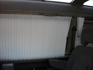

And here we have it! New, Clean, Crisp curtains!
Curtains Open
Curtains Open
And then when they are closed...
Curtains Closed
Curtains Closed
Sandy also made front and back curtains using the same frabric that was used to hold the curtains open. She added velcro to the top portion and it just sticks to the head liner behind the rear seats and then in front of the driver and passenger seats.
Well, there you go. I hope you like them and now you can make your own NEW curtains too!
