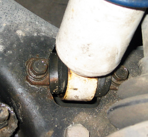

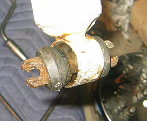

Hi All,
While installing manual hubs I discovered something odd on the left side. Now I am wondering who to blame: the product quality, the installer or just my bad luck. Also I would like to know if anything can be done to fix the bushing or the shock needs to be replaced.
Thank you in advance.
Sergiy.
Sergiy.

Sergiy,
The rubber bushings get worn out pretty quick. That's a known issue. You should change them to polyurethane bushings. Just a few bugs, but will improve the lifetime of your shocks a lot.

I got mine at North Shore Offroad, but I'm pretty sure other shop will have them too.Profister wrote:Thanks Felix, and where should I go for polyurethane bushings?

what is the moister around the connection? did you spray it with something or is the shock leaking?

Profister,
How long have you had those shocks installed ? I remember when I did mine, I had a bitch of a time putting the bar through the bushing. I had to gease the heck out of it and had to press the bushing back in using a vise.

x2 the poly bushings are much betterfexlboi wrote:Sergiy,

Wrong type of bushings for that type of mount. You need one piece bushings, not the 2 piece units. You probably did not get the right kit for the application -

That was my guess. I was wondering how the hell two pieces could stay in place without anything holding them from the sides!Wrong type of bushings for that type of mount. You need one piece bushings, not the 2 piece units.
Golf Cart - I bought these shocks from Mardy and installed by RJD in June last year.

Profister wrote:That was my guess. I was wondering how the hell two pieces could stay in place without anything holding them from the sides!Wrong type of bushings for that type of mount. You need one piece bushings, not the 2 piece units.
Thats odd. I bought mine in September from Mardy and they were one piece bushing that were an hour glass shape. From your pic, it looked like the bushing split in half

I am not sure if it was one piece and it just torn apart or there were two pieces originally but it needs to be replaced for sure. Looking at the mounting I do not like it at all to be honest.
Great thanks everybody for your help.
Sergiy.

I think so too.Golf Cart wrote:...it looked like the bushing split in half

Hi, that was the right 1pcs. its only have on pcs. not 2
its just the way they put is not much stronger. need the urethane one they say some shock they put urethane.
i already inform pro comp about this just let me know when you have time to come buy & will give you one with urethane robber.
cheers;
