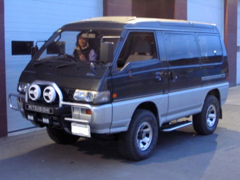

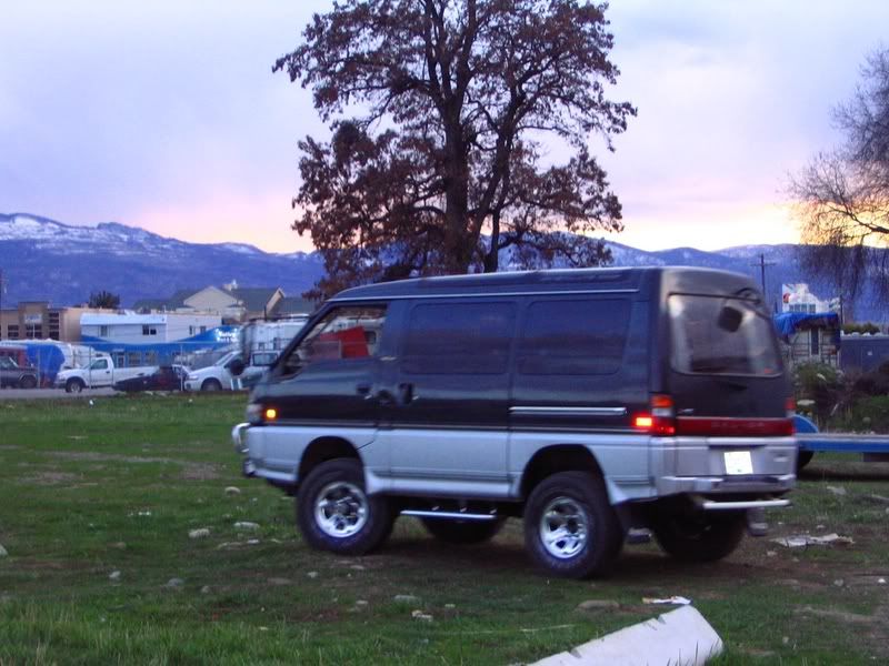

Just to give you guys an update. Since we had the springs re-arched the van is much more stable and the ride is good and solid. If you're thinking of blocks or shackles (both of which are good easy ways of lifting without affecting ride quality) you should still have your leaf springs examined. If there is obvious spring sag which you can see by irregular spacing among the leafs, such as the top one being sort of flat and the bottom ones arching away from it, then installing blocks or extended shackles is kind of a band-aid approach.
Regarding add-a-leafs, I have had mixed experiences with them. On my Tacoma I hated them and removed them because they made the rear super stiff and caused the shocks to top out over speed bumps (stock shocks, I know I needed longer ones). On a Delica it may work better as there is significantly more weight on the rear end.
In our case, the leafs had obviously sagged over time and the wear in the back seats points to our van being used regularly to haul people. By re-arching we are bringing the rear suspension closer to original. Some vans may have good rear springs, some may have sagged.
All I can say is start with a strong suspension before bolting things to it to make the vehicle sit higher. Squishy springs and a higher centre of gravity are not a good combination.
By the way, Wayne is right about pinion angles, use shackles over blocks, especially with our short wheelbase.
We had the front cranked pretty high, it has now been levelled and then final adjustments were made during the alignment.

good looking van, congrates..
one thing many people do nto do is research the add-a-leaf (AAL) before installing...they walk into the shop and go "i need a AAL" the parts drone behind the desk whips open his catalogue and goes "ah, this is the one you need" and off you go...trusting the kid that has never installed an AAL in his life...
another problem i have seen is people stick the AAL on without removing any of the stock leafs...wrong. you remove all leafs that are the same length or shorter than the AAL.
i have found an AAL for the Cruisers that were made for the Jeep crowd. it gives good lift (about 2-3") and a very nice ride. it felxes extremely well and costs about $90 a pair. (of course i had to test run a few different sets to find the right ones)
Rancho makes a good set but there are 2 different part numbers, the one is a VERY harsh ride, the other is perfect...
cheers

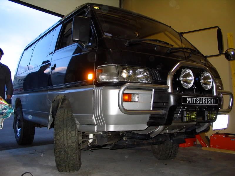

Front skid bars
Leafster, I was looking at your pictures and wondering about the front
bars that run forward of the front wheels. I see yours have been removed. I'm currently over-researching my Delica purchase, as I do with everything I purchase and I've noticed some lifted Deli's have these
bars removed and some don't. Is there a particular reason for this or is it purely for looks?
