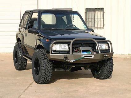

after the winter i will try to fit the bumper that i used to have on my sidekick with some slight mods to it obviously, so then i will just remove the whole system but figured it'd be cool in the mean time 8-)
hear is a picture of my sidekick bumper.... should look cool, but still need some serious planning to see if it'll work.... it could also look crap haha

Sweet bumper!

Very cool bumper...something like what I had in my mind when I first bought a welder and figured I could make a Deli bumper...well, now i know that isn't the case, but I haven't given up. Still working on something...I'm calling it "frankenbumper" and I'm going to be happy with it because I will have learned alot making it - though it may be ugly as hell!

good luck with that bumper!!
it's true welding and fabbing always looks good on paper and is super hard to duplicate in real life... for the garage hobbyist anyway!!! i didn't make the bumper obviously... it's from www.shrockworks.com but when i am welding stuff together i find less is more!!! keep it simple!!!
PHIL, how much did you pay for the E.C.B.?? (if you don't mind my asking) and do you know how much it weighs??? i'm worried that the Shrockworks one will be quite heavy for an already heavy truck
it weighs in a 100lbs and 170lbs with the winch
