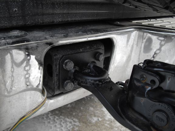

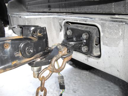

well i ended up fabing up a cheap alternative to ordering a tow hitch...
i took one of the "flat bar" style ball mounts (i think it's called class 1) and cut it a bit short and then welded it to the factory tow point on the pajero
i already had both the bar and ball but i have seen similar stuff at Princess Auto for about $8 for a 2inch ball and $22 for the flat bar ball mount.
the factory tow point made a lot of "Real estate" to weld around if you could imagine having the flat bar butted against the flat piece that the four bolts holes are in and the top of the bar against the tow hoop.... so i could weld around the inside and outside of the hoop
again i will post pictures as soon as i get a new digital camera!!
anyway i will only be hauling a small 4x8ft utility trailer so this should be more then strong enough

i borrowed the inlaws camera to post the pics of the trailer mount.... not the prettiest weld no doubt so just ignore it hahaha
but works great.... if you've got the parts and wanted me to do some welding for you i'd be happy to take beer in exchange!!
