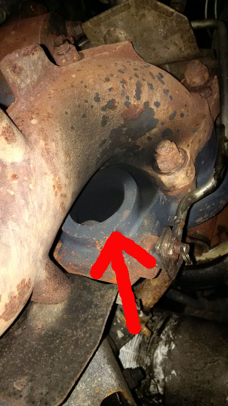

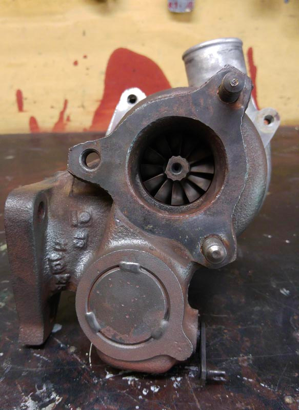

Am I the only one in this community that has not just once but twice the turbo plug pop out from 2 different brand new turbos? Well the second one was 3 years old.
This is very annoying. Do you guys carry a 2nd turbo all the time with you guys?
Anyone?

The Mitsubishi turbos I've seen come with that plug welded in place:
I can't see any evidence of broken welds in your picture, so I'm presuming that's an aftermarket turbo. I'd weld a plug back in place rather than buy a whole new turbo. You might want to check your exhaust too, there might be excessive backpressure from a dented pipe or internally collapsed silencer.

Yes I will have a new plug inserted and welded on one of the 3 turbos I have at home. 2 brand new, had about 5000km on them. One has a pretty deep crack in the housing (not the turbine part) and the other one is leaking oil. At ranging between 400$ and 600$, you'd expect them to last longer than that.
So again, my question to you guys was, am I the only one to have such issues with turbos? Am I the only one that have to change them every couple of years?
