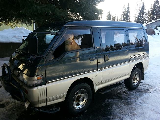

Well here it is! The start of my new project!
92 L300 Delica 209000kms
Work that needs to be done
-Engine needs to be replaced as its done...looking for new or used not sure yet wich way to go
-Need seats for the back as there are none.
-Back door panel is missing
-windshield needs to be replaced
-rear bumper corner damaged so i want to replace.
Thats it to start! :shock: :M

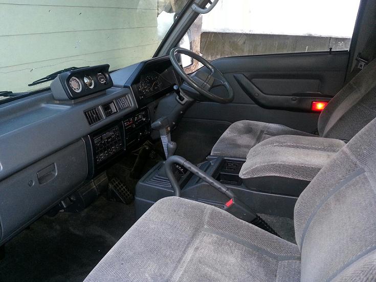

Spent a few hours just cleaning the interior, looks way better now after a few buckets of black water......

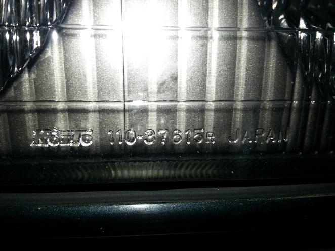

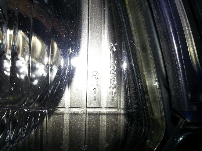

Ok so had a look at the headlights on this thing and im not sure if they got changed....(just looked up Koito on here and think I found my answer...)starting to wonder who inspected it...put it in my name at ICBC with no problems so I think it must have been inspected at some point....have to look for a decal havent seen that yet

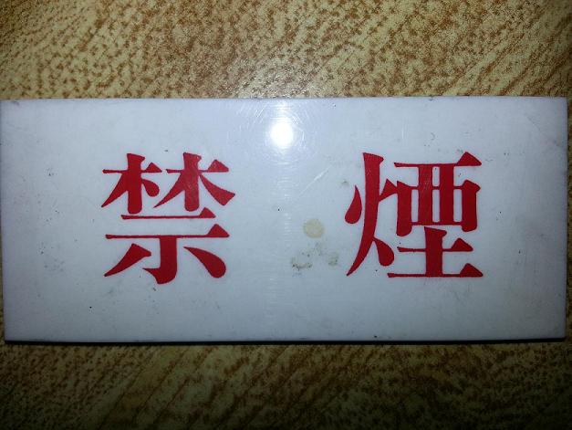

And this was attached to the dash anyone know what it means? or says?
yojimbo
Posts: 544
Location: Bucks, UK
Re: My New 92 Delica Project
Post by yojimbo »
No Smoking.

Pajero wrote:Ok so had a look at the headlights on this thing and im not sure if they got changed....(just looked up Koito on here and think I found my answer...)starting to wonder who inspected it...put it in my name at ICBC with no problems so I think it must have been inspected at some point....have to look for a decal havent seen that yet
Chances are with the Japan tag on the lenses I'd say they are not up to code. Is there a number in a circle? That will give you the "E" code which you can compare in this thread. Ultimately if you shine your headlamps against a wall and the flare goes to the left the lamps are designed for vehicles that drive on the left side of the road. If they flare to the right then they are designed for vehicles that drive on the right side of the road, like in Canada. If the flare goes to the left then you are blinding the oncoming traffic, much like driving with one's high beams on.
