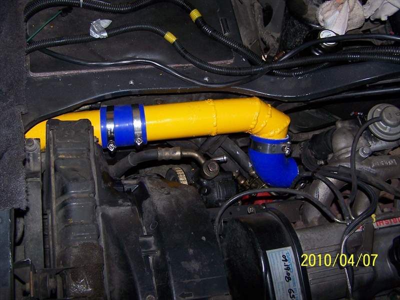

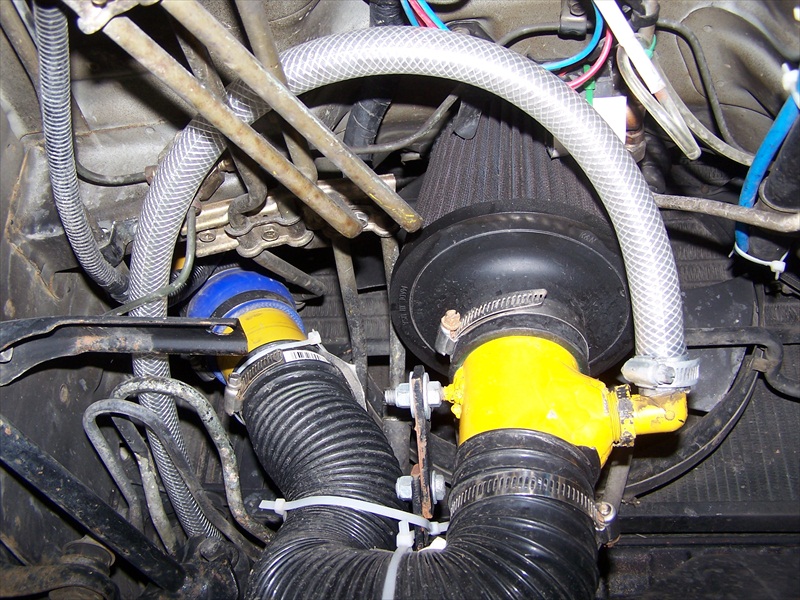

Dustin here is where you put the pipe to have your intake in the front. Works great! The original work and routing was done by GaryO for an intercooler. I haven't got that ambitious yet.
- 2.5" intake pipe to front of Van

- K&N filter vertically in front of Rad
- 100_5584A.jpg (244.14 KiB) Viewed 4872 times

Thanks for the pics gives me some ideas but, I think I will relook at a slightly different routing.
I have to do some measurements and maybe some Fab

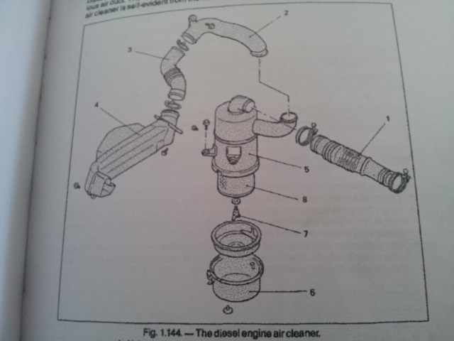

Ok so after looking around under the deli and looking at the air ducting. I desided to look thru the three manuals I have one fro japan and a peter russek one and a mitsu petrol version. I know people say the air gap between the two ducts is suppose to be there but the manuals say other wise i wil post pic to prove.
I am hooking my two ducts back together thus getting a bit of ram air effect and preventing the dust from blowing up into the air box area from clogging the filter.
In the pic the duct is labeled number 3
If someone can give hard proof this should not be here then please show it.
Dustin
Dustin
- 20120810_105937.jpg (153.09 KiB) Viewed 4837 times

Interesting. Is that illustration out of the Russek manual? I have often wondered why there is a hatch to the top of the filter ~ I figured it was just to access the steering pump reservoir ~ but with all the other cool practicalities these wagons have, it compelled me to ponder.

that one is out of the russek manual, but its also in my mits gas one. I already have my plans in place will pick up parts and fab a connector pipe with a drop down/clean out. To allow heavy particles to fall out. I will do a write up with picks. Plans code name ''Minding the Gap''
