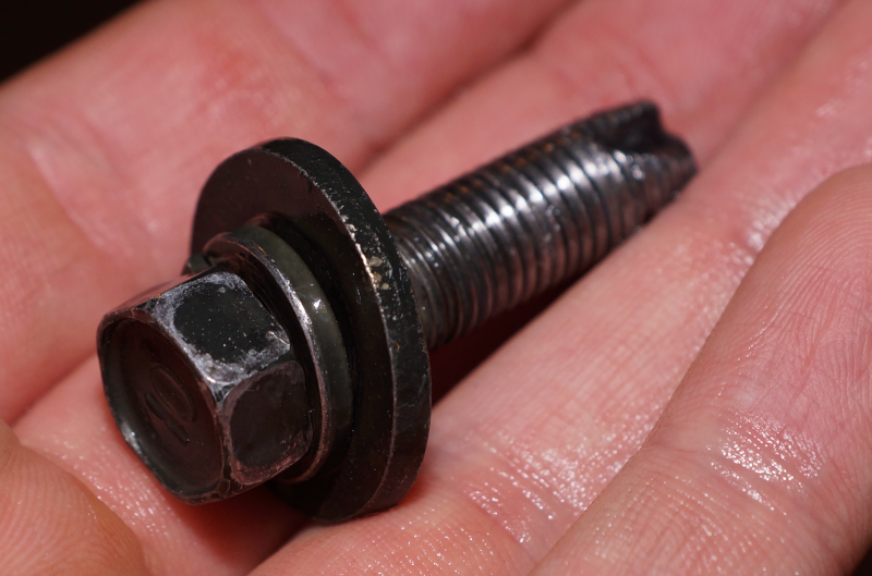

So, I removed my drivers seat today to replace the heated seat elements (directions to follow in the other thread) when I finished, I brought my seat back out and began to tighten the bolts. Much to my dismay, I found that two of the bolts stripped! So, now I can't safely drive my Delica!
(I am going to try stealing 2 bolts from the passengers seat as a temp fix).
I went to Home Depot, and they had nothing. Does Mitsubishi proper have bolts for the Montero that would work? Is there a real risk that I need to get the holes re-threaded now?

I just re-tapped mine when it stripped and put in a bolt from home depot.

standard metric thread take a good one into any autoparts, motorcycle shop and they should have.

I got mine at a Honda shop. They have all the strange ones.

Thanks. Just stole the identical bolts from the rails of the middle seats, since I don't need anyone to sit in there. Guess I should also invest in a tap and die set as well.
