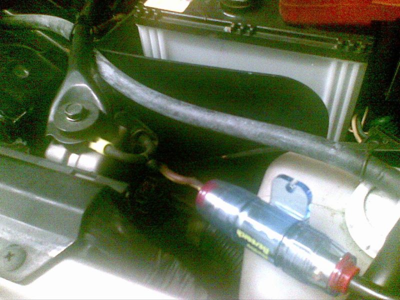

jfarsang wrote:Stock Pajero rad.
Whole 1pc shroud/fan/motor from Taurus mid 90's 3.8v6.
$30 from wrecker.
Just tossed an inline fuse (below pic) and a solenoid.
Everything seems to be the same.
Except no fan clutch and I can control fan .. OFF/LOW/HIGH.
I like it because if I'm doing a water crossing, I can turn it off.
2 setting. Low (nice normal) and turbine tossin' high.
The reason I did it is because after the 2" body lift, I found the shroud won't go back on and the taurus fan was there, $30, had some time and just put it in.
I see no benefit to put it in except for water crossing to turn it off and after doing a body lift.
