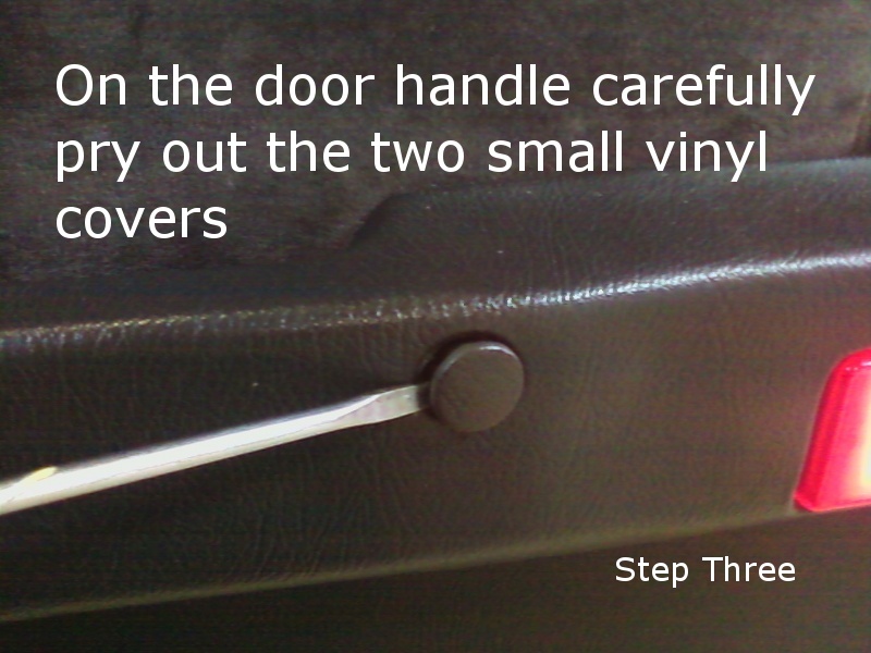

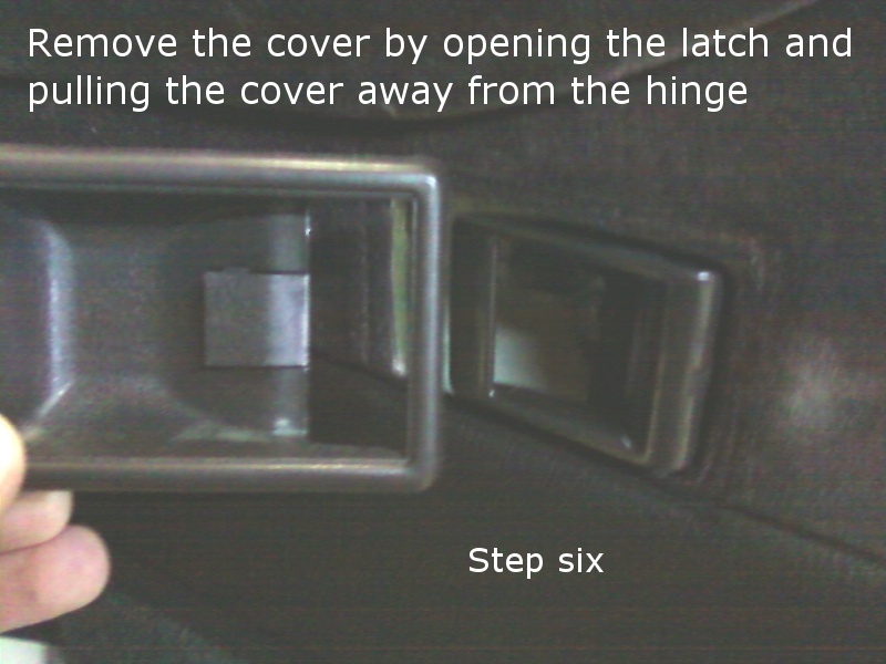

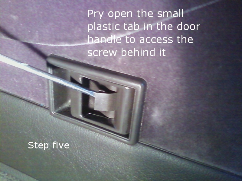

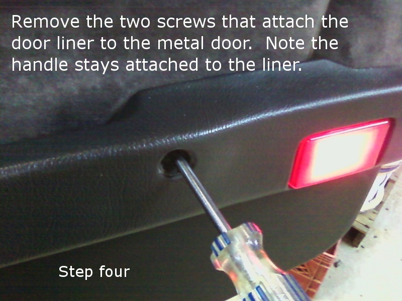

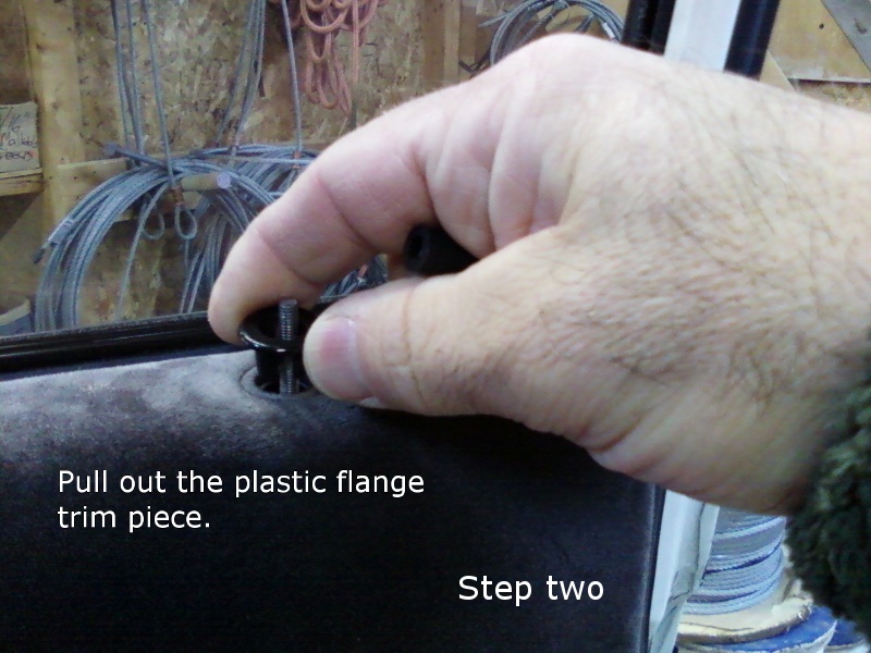

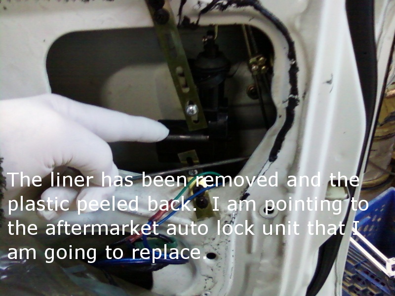

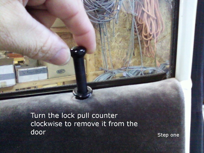

How to remove a door panel. I have more than seven pictures so they are divided over two postings because I read that we can/should only add a max of seven photos to a post.
- one.jpg (182.5 KiB) Viewed 11858 times
- two.jpg (156.98 KiB) Viewed 11858 times
- three.jpg (135.83 KiB) Viewed 11858 times
- four.jpg (144.92 KiB) Viewed 11858 times
- five.jpg (139.78 KiB) Viewed 11858 times
- six.jpg (120.87 KiB) Viewed 11858 times

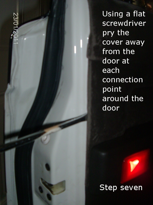

On step seven I use a large flat screw driver but there is a specific tool that can be purchased to do the job. The screwdriver worked fine for me.

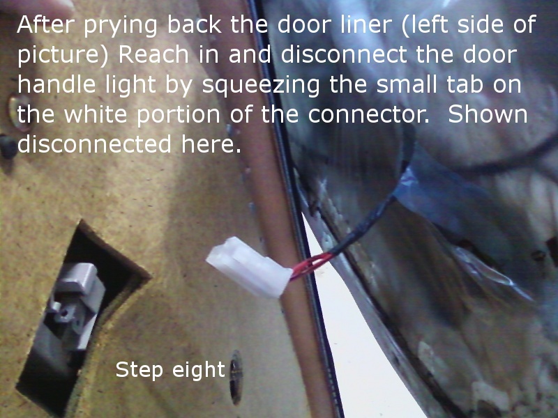

On step eight I took apart the door light from the back but I had read in another post that an alternative is to remove the light cover and unscrew the light fixture from the panel.

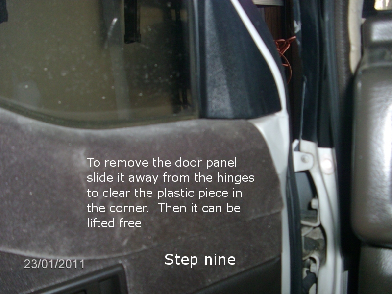

On step nine I tried to put an arrow to the section I was describing but my computer skills maxed out. So I am describing the area where the door panel (gray) meets the plastic piece (black) in the window corner.
