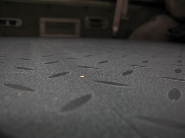

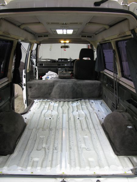

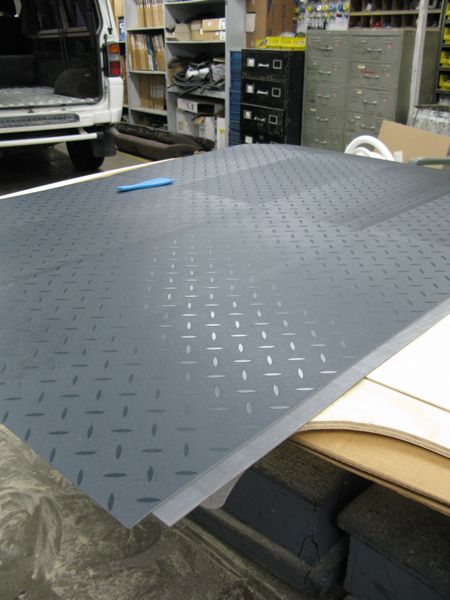

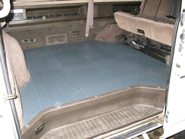

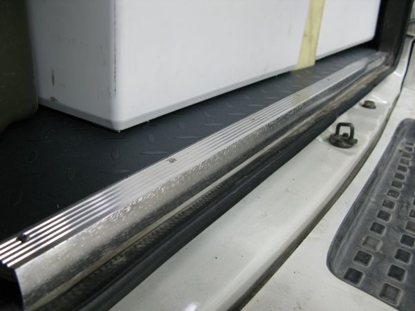

Finding the right material was already a challenge. Initially I want to use Phenolic plywood, but unfortunately it's not available in BC not even something similar. So we try to find an alternative. We ended up using normal plywood and as the top layer very durable garage floor vinyl tiles from HomeDepot. The tiles had adhesive lips on each side and as we glued them together the sheet was almost as heavy as the peace of plywood :) In the end we don't even have to glue the tiles to the plywood. So easy to change in the future. We are really happy with the finished piece and don't have to worry about wet snowshoes, snowboards or dirty mountainbike stuff in our van.

This floor is great and perfect for our camping set-up! No way I want the carpet back.
