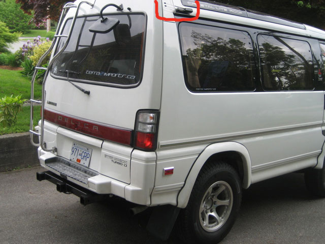

Off topic: I saw it already on a few Delicas. Some of them had it on the roof. What is that in the red circle?glenn wrote:I just finished installing one of the maximum overdrive hitches for $380. It's pretty much as described earlier, plus it comes with a receiver and ball. It's very easy to install, bolts right on around the spare. Bolts both to the bumper and to the frame. There are flanges that have to be removed before it will fit properly. I was told they were going to be removed, then after waiting 20 mins was given a hitch - only to discover it wasn't done once I got it home?

- what_is_that.jpg (70.29 KiB) Viewed 9848 times

It is probably the TV antennae - I had one on either side of my van when i got it - got rid of them when I got rid of the Japanese stereo and TV.

Yes, TV antennae.fexlboi wrote:Off topic: I saw it already on a few Delicas. Some of them had it on the roof. What is that in the red circle?glenn wrote:I just finished installing one of the maximum overdrive hitches for $380. It's pretty much as described earlier, plus it comes with a receiver and ball. It's very easy to install, bolts right on around the spare. Bolts both to the bumper and to the frame. There are flanges that have to be removed before it will fit properly. I was told they were going to be removed, then after waiting 20 mins was given a hitch - only to discover it wasn't done once I got it home?

Yes, those are tv antennae. Like quadzilla, my van came with a useless-to-me Japanese stereo and tv with a Japanese cd rom based map system. State of the art in 1993 I'm sure. I haven't gotten around to taking them off yet.
