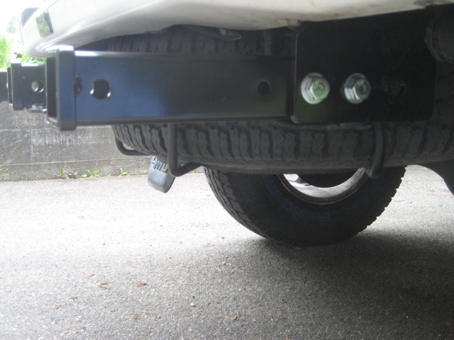

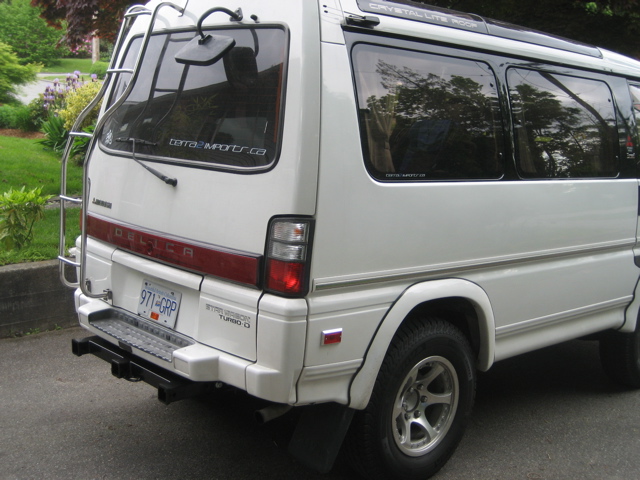

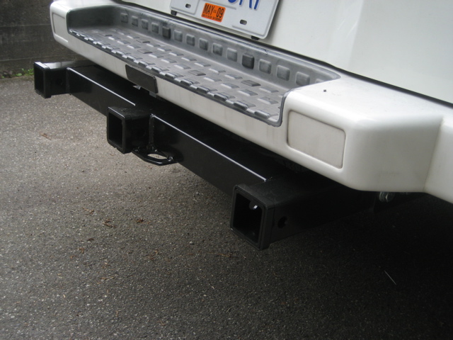

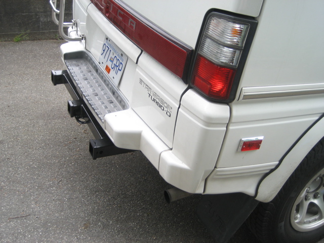

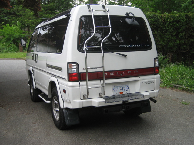

I just finished installing one of the maximum overdrive hitches for $380. It's pretty much as described earlier, plus it comes with a receiver and ball. It's very easy to install, bolts right on around the spare. Bolts both to the bumper and to the frame. There are flanges that have to be removed before it will fit properly. I was told they were going to be removed, then after waiting 20 mins was given a hitch - only to discover it wasn't done once I got it home?
at any rate, this hitch will serve me well, and if you don't mind being treated with indifference when you buy it, it's not a bad option.

If it hasn't been done yet you should replace the bolts with high strength ones (they are yellowish in color) and use lock washer instead of the nylon lockers.
I've used a 24" bar to torque the nuts to around 100lbs and the rear part of the hitch still ended up moving down a few inches (not the part connected to the sub-frame but the part with the 3 receivers). I'll re-align it again and tack-weld it so it no longer moves.
Aside from that it's not a bad hitch. I'm not sure what flanges you were hoping to have removed? The only mods required is if you have a torsion bar you need to remove about 1/4" from the tabs butting against the torsion bar nuts where they connect to the frame.

Before it was delivered to, the brackets were trimmed off 1/4 inches so that it won't interfere with the bolts for linkage. Flanges or Bracket don't need to be removed.glenn wrote:I just finished installing one of the maximum overdrive hitches for $380. It's pretty much as described earlier, plus it comes with a receiver and ball. It's very easy to install, bolts right on around the spare. Bolts both to the bumper and to the frame. There are flanges that have to be removed before it will fit properly. I was told they were going to be removed, then after waiting 20 mins was given a hitch - only to discover it wasn't done once I got it home?

I just finished installing a max overdrive hitch as well. Overall I'm pleased and it's very solid.
I had a bit of unforseen trouble, because my camper-deli is based on a work model Delica... no rear bumper bar or mounting holes! After removing the plastic and metal rear end bits, I was able to hole-saw 1" access holes and drill bolts through the locations where the bumper bar mounts should have been. On the plus side I figure it's a bit stronger , with 1/2" grade 8 bolts instead of the 3/8 bumper screws.
However same as delicat says above, I found that after carefully leveling the hitch brackets with high strength washers, the receiver part does move around up and down, settling at an overall downward angle after jumping up and down on it, despite plenty of tightening torque. doh! I like the 2-piece design, but this is the downside. I don't weld, so I'm not sure what to do to get the angle right, short of disassembling the bumper again and removing washers to bring the angle up abnormally on the brackets.
I have to wholeheartedly agree about replacing the connecting hardware with grade 8 high strength. I used one of the bolts provided, to temporarily hold the bracket and hitch bar together, and accidentally tightened a nut around it with mismatched thread (a grade 5 nut from home depot). After realizing it, I had to reef on the wrench to get it off, and in doing so snapped the max-overdrive-provided bolt in half with a 12" wrench and arm strength! Not so good... let me just say that I'm glad I heeded the advice here and got new hardware...use the included stuff at your own risk...

I was just thinking about it, we have may trimmed the opposite side of the brakcet. If we did so, my appologies, next time you are around our shop, I will give you 2 oil filters free.mdrive wrote:Before it was delivered to, the brackets were trimmed off 1/4 inches so that it won't interfere with the bolts for linkage. Flanges or Bracket don't need to be removed.glenn wrote:I just finished installing one of the maximum overdrive hitches for $380. It's pretty much as described earlier, plus it comes with a receiver and ball. It's very easy to install, bolts right on around the spare. Bolts both to the bumper and to the frame. There are flanges that have to be removed before it will fit properly. I was told they were going to be removed, then after waiting 20 mins was given a hitch - only to discover it wasn't done once I got it home?
Sabbir
We will provide idustrial strength bolts from now on with the hitch as it deemed necessary.
