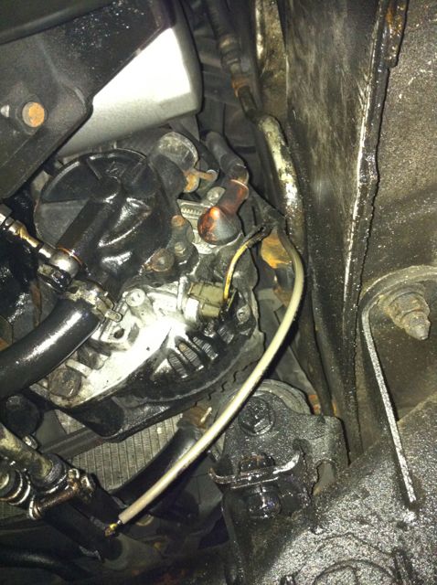

Hmmm... just found this.
It appears to be a disconnected ground wire coming from a cluster that hooks to the alternator. It's actually black or dark grey.
Can anyone confirm where this is supposed to be connected?
Thanks,
Shane.

The alternator is grounded (-) to the chassis, there is a 4 gauge hot terminal (+) and a connector terminal (2 pins IIRC) that goes to the regulator. You can see these are both connected in your photo.

Thanks. I'll re-attach that ground and see if any of my mystery is resolved.
