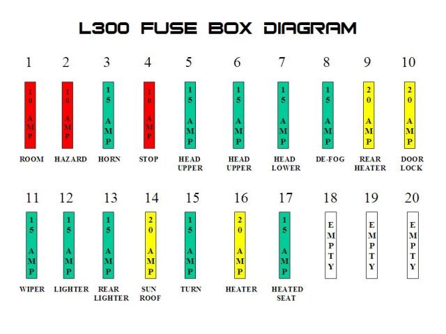

Re: very wierd electrical problem
I hope this helps... smiles.
- L300FuseBox2.jpg (39.58 KiB) Viewed 6841 times
cool that saves me searching for the diagram...
