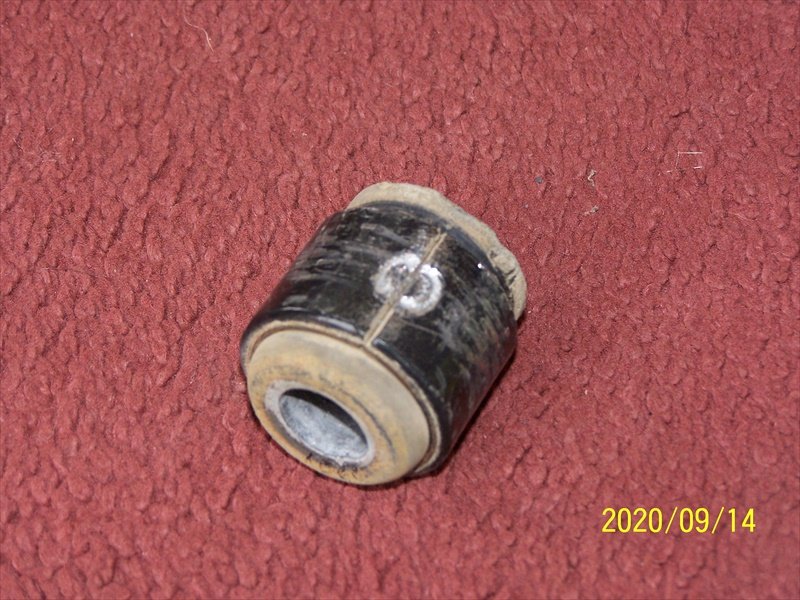

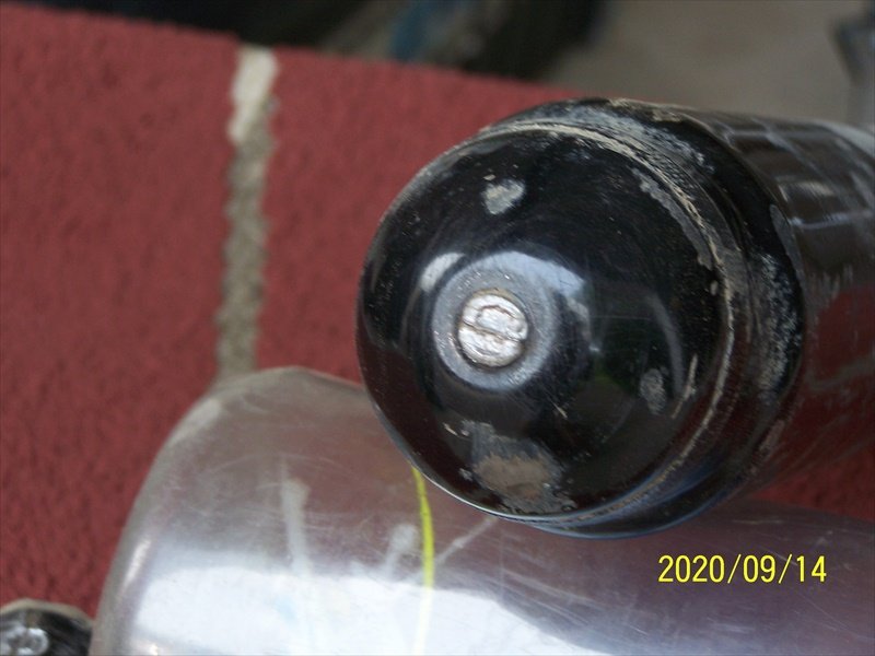

I discovered this week that my air shocks have failed. I installed them in March and only have a few thousand km on them. The top broke off which is the opposite end to sk66. I'm not sure how they welded it together but if that's all that's holding then it's no wonder they don't last long. Rather than by more I decided that nothing is lost to try and weld them and so far they work fine. We'll see after they spend some time on corduroy back roads. I've attached a couple of pictures so you can see the original 'weld'.

Re: Air adjustable shock absorbers
Well the other shock broke @ the top on the weekend exactly the same as the first one. I could have taken another picture and it would have been exactly the same. The good news is the first one is still holding and I've welded this one so I have 2 'good' shocks again. See how long they stay in one piece this time.
