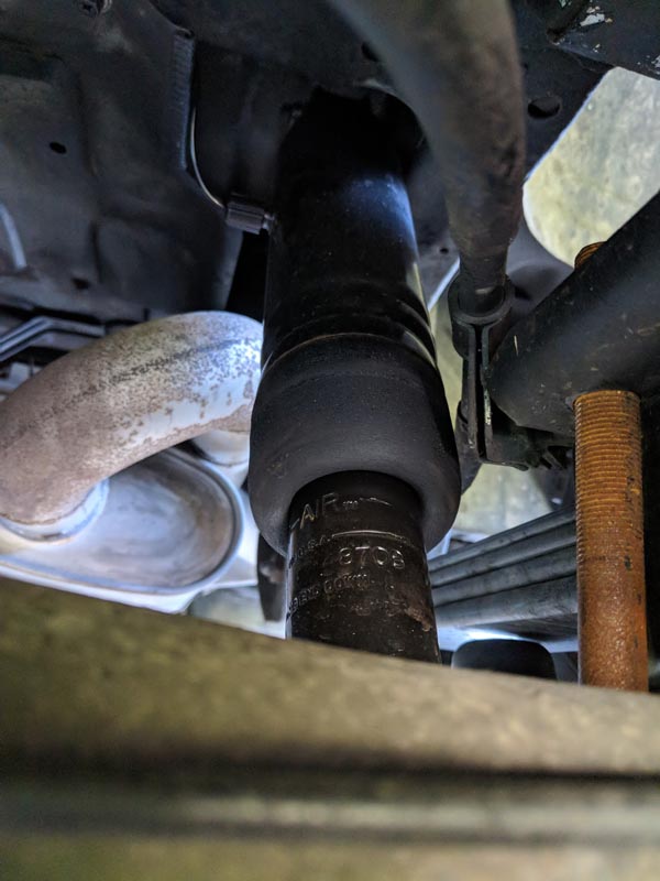

Monroe MA708.
(http://www.monroe.com/en-US/e-catalog/MA708/) US$70 from Amazon.
Allegedly the same compressed and extended length as my Pro-Comp 919520's (https://www.procompusa.com/eSearch.aspx ... Ntt=919520) but I think they're measuring from different points, because these clearly have a *lot* more droop than the Pro-Comps. They're also slightly longer when compressed, presumably because they have internal bump stops, but by my measurements they shouldn't bottom out (and the internal bump stops should prevent any damage if they do).

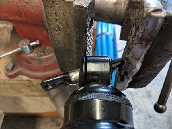

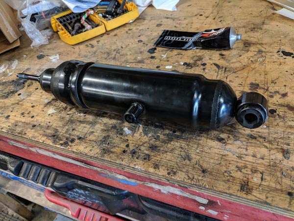

They require a touch of modification. Remove the upper pin mount (it's more difficult than it looks, but keep at it) :
...and install the bush from your old shocks (because the Monroe bush's hole is too small to fit over the Delica's mounting pin):

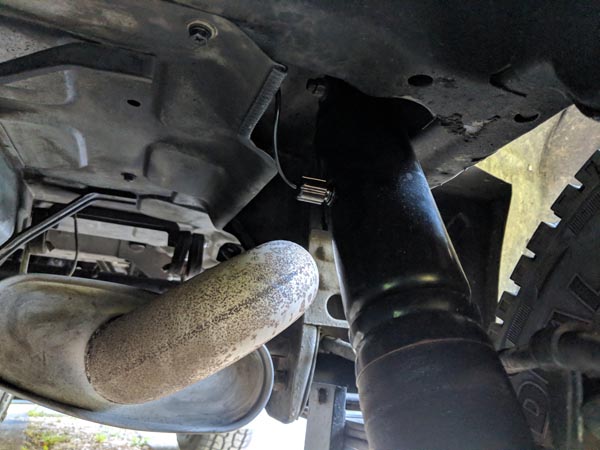

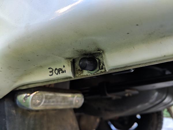

They work brilliantly so far. Just 30psi brings the rear end back up to standard height, lifting the tired springs off the overload leaves, and restores the smooth ride. With the caravan hitched up and a bunch of junk in the van it required 70psi to come back to standard ride height, and it tows without any wallow or pitching.
Monroe recommend 20-90psi continuously (so I'm well within the specs), or up to 150psi for short periods. Air shocks have a reputation for overloading the shock mount points when used on regular cars, but I figure our beefed-up 4WD mounts can handle it. (Or watch this space for a thread titled "Shock absorber mount point repair and strengthening".)

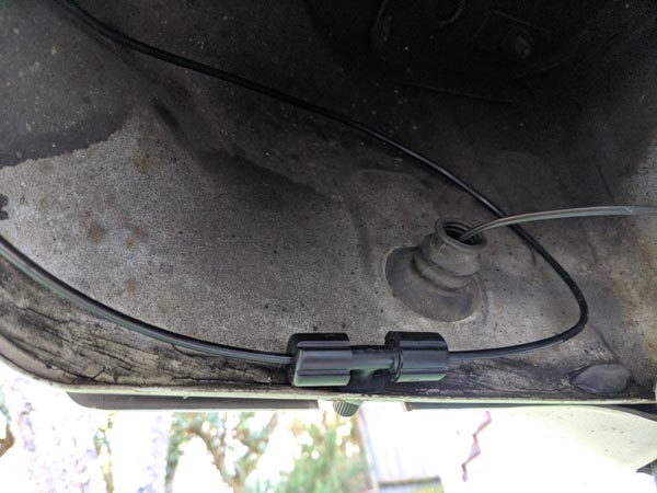

I'm kind of running into the same issue. I was gonna add another leaf or get new leaf springs built.. but I was wondering if there was an airbag or air shock option. What do you use to pump it up? just a air hose or do you have a compressor on the vehicle?

I just use an air hose. (UPDATE: I've now installed an onboard compressor. C'mon, you *knew* it was going to happen. http://www.delica.ca/forum/viewtopic.php?f=10&t=18849). The shocks have an air line kit with a tee that ends in a regular Schrader (tyre) valve.
I have a compressor in the van, but it's a tiny emergency one. I could use it to inflate the shocks if something went wrong, I guess.

I removed the pin and bushing, it took a bit of effort using the vice. The bushing isn't bonded in though, so you could easily reinstall it.

It was time for new shocks for my van so I installed a set of these shocks yesterday. Took me much longer than expected, mainly just getting the 25year old nuts off the old pin. The new shock bushings have a much smaller ID, so the old bushings are required. Also my hose routing is no where near as tidy, but they hold air and stop the van from getting so loose on washboard dirt roads, so success so far. Thanks for the idea.

I also installed these today. Not sure how you got the original bushes into the eyes as they are much larger.
The pins are the same diameter, but there is no way I could get the new bushes onto the suspension pins while under the van. Instead I bored the new bushes out to 5/8" which made for a nice tight fit.

sk66 wrote:Not sure how you got the original bushes into the eyes as they are much larger.
Rubber grease and a bench vise, from memory. I don't recall any issues fitting them to the pins, but maybe yours are different in some way.

Nope the 708's have a smaller pin opening (same diameter pin pressed in). I couldn't fit them to the shock mounts even with grease. The shock eyelets on the 708's are significantly smaller... I didn't even try pressing in the old bushes, just reamed out the new ones.
