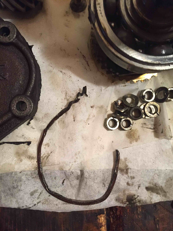

This has so far been the most helpful info I've gotten on the L300 transmission, so I will post my question here even though I'm not necessarily doing a tranny swap myself. I've been having tranny issues with my 1991 5spd l300 (Trannys a V5M21), and so I dropped the tranny out and have been going through it to find the cause of the issues. Upon inspection found lots of metal shavings, including some brass. Mainshaft bearing was shot and now replaced and will likely replace synchros as well, they look pretty worn(will include some pictures in a reply). My main concern is having found this chunk of metal that appears to be a seal or something of that nature jammed up in a shift arm. I couldn't figure out where it came from even with schematics of the broken down tranny.
The only other thing I could find is that at some point someone removed an exterior bolt that released a spring holding pressure on a shift arm inside the tranny. But this could not have been the cause for the terrible noises it made near the end, as no one had worked on it for some time before this.
Best case scenario I'm able to order in the new synchros and all is well once put back together (minus the mystery metal...).
Any advice would be greatly appreciated, I'm not a mechanic so I'm learning as I go. Thanks!
Converting from Automatic to Manual: Manual gearbox rebuild
That does indeed look like part of a seal, or some kind of crushable gasket, but I can't think of anything in the gearbox that it would come from. Maybe it got in there when the gearbox was last opened up?

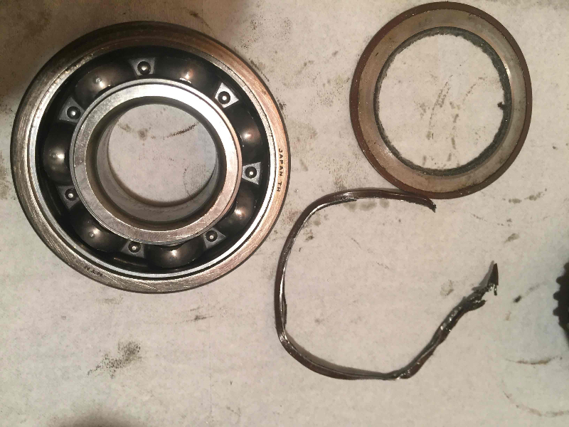

So having dug even deeper into my transmission, I have a theory on what might have happened.
It seems the main input shaft bearing was an upgraded version with felt seals. Assuming that the bearing is fitted with a seal on both sides of it, I've resolved that the aforementioned piece of metal (Looked like a gasket or seal) was actually from the felt seal. When taking the tranny apart, I only found the one felt seal, and it wasn't even seated in the bearing, this was because the bearing was so warn out, I'm assuming it literally just just got thrashed and forced out.
This picture shows the warn out bearing with the one felt seal that survived, and the remaining outer gasket ring of the other felt seal that didn't get shredded on the inside of the transmission box. This also means that all the felt and other metal on the seal got completely chewed up inside.

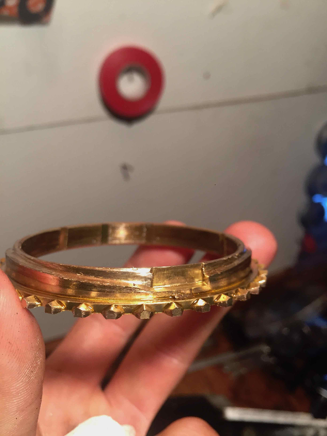

I'm guessing the internal felt seal then got sucked into 3rd/4th gear synchro, and chewed up a bunch of the brass on the first synchro and the outer gasket that remained proceeded to get lodged in a shift arm where I found it. The 3rd/4th synchro now looks like this... not good..:
I've replaced the main input shaft bearing with a new one (without the felt seals), and need to order in a new synchro.

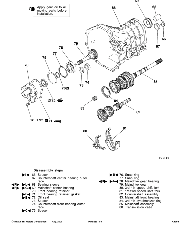

This seems to be the most challenging part of this rebuild, identifying the correct part number to get a new synchro ordered in. Using the previously mentioned parts search engine ( https://partsouq.com/) I can't find numbers for synchros. This diagram I've been using for the rebuild, only shows me which part it is, number 84 (3rd 4th synchronizing ring):
V5M21-9-G Transmission.png (209 KiB) Viewed 7812 times

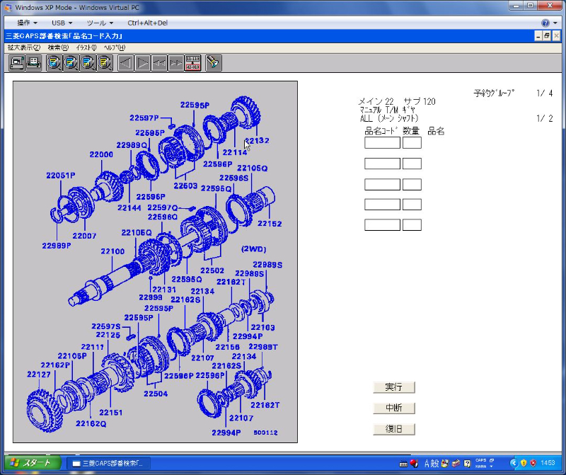

I've talked with a local JDM dealer that sent me this diagram to identify it and get it shipped in. The diagram is low quality somehow doesn't look quite accurate... but my best guess is that it's 22596P ... but it's hard to tell, and possibly it's 22596Q, Any opinions here? :
Anyway, regardless of it's specific part number, upon visual inspection, it appears to be identical to the other synchronizers in the tranny, so I'll likely go with the ring I've identified above, unless anyone else on the forum knows a better way of identifying and/or purchasing this part? Thanks in advance!

It's item 22596P, Mitsubishi part number MD701465. The same ring is used on 3rd,4th, 5th, and reverse.
I've been using ilcats.ru lately, much clearer diagrams, and when parts change the changeover dates are right there in the parts listing.
https://www.ilcats.ru/mitsubishi/?funct ... anguage=en
