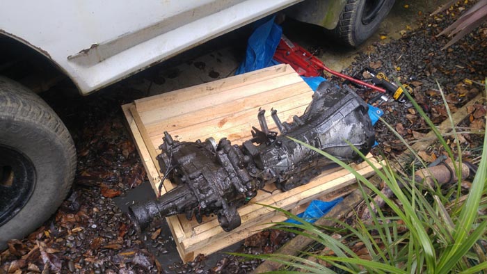

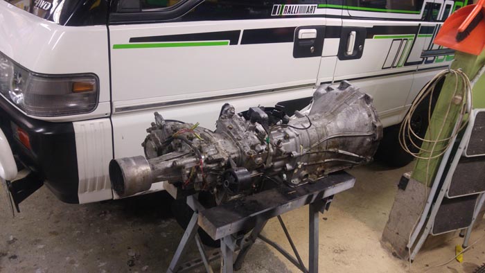

Progress continues. The Automatic and Manual bodyshells are identical, so far there's been no drama in swapping the parts. There's even a hole in the floor for the clutch line bulkhead fitting, and a tag on the frame near the bellhousing for the clutch flex line to attach to. Witness the new bulkhead fitting (and the shameful collection of fluff and junk that lives under the carpet:)
My new gearbox is in pretty good condition, considering it's done 360,000km. The mainshaft retaining nut that holds 5th gear in place was only slightly loose, the staked section had stopped it coming undone (which would have wrecked the gearbox). I'll be using loctite when reassembling.
All gearbox bearings, seals, and synchros are still available, so I've ordered them all (might as well, since it's pulled apart). Selector forks are NLA which is a bit disappointing, since the forks are a bit worn.

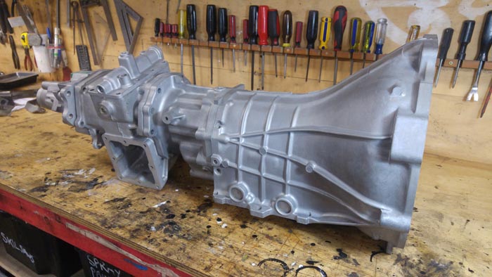

So. What to do while waiting for parts to arrive from Japan? Clean and bead blast the gearbox cases:
Mmm pretty.

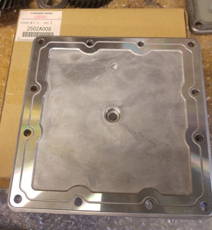

A cast aluminium lower cover, which replaces the pressed steel cover. Fitted to the Mitsubishi Starion for only two years (1988-89) with original part number MD727553, no longer available, and rare as hell. Starion and 4WD guys have been making their own versions out of alloy plate at enormous expense. (http://projectzerog.com/forum/viewtopic ... 6c461631ff , http://www.starquestclub.com/forum/inde ... pic=100703.
...except... they're not rare or unavailable. Mitsubishi put them back into production in 2000, albeit with a different part number.
Part 2502A008. CAD$52. You'll also need the O-ring seal MD727531, CAD$17. Definitely fits a V5M21, should also fit a KM145.
Next post: Input shaft bearing and 5th gear strengthening.

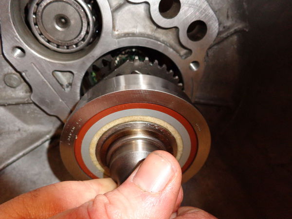

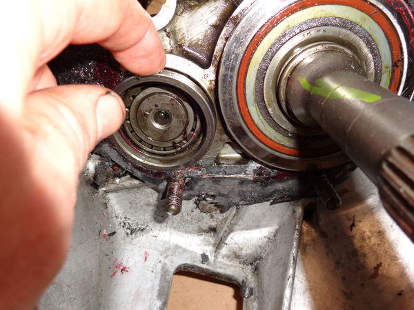

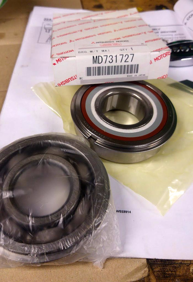

The input shaft bearing is a known weak spot- they tend to collect metal particles and fail. Something to do with the flow of oil in the case, I suspect.
Early gearboxes (and cheap rebuild kits) have open bearings, but Mitsubishi upgraded the input bearing to have felt seals, which let the oil in but keep the swarf out. Compare the upgraded bearing to a cheap replacement:
Genuine part MD731727 is the snap-ring style input bearing with the fancy seals. (Check that your gearbox uses a snap-ring style bearing first, as some had a flanged bearing.)

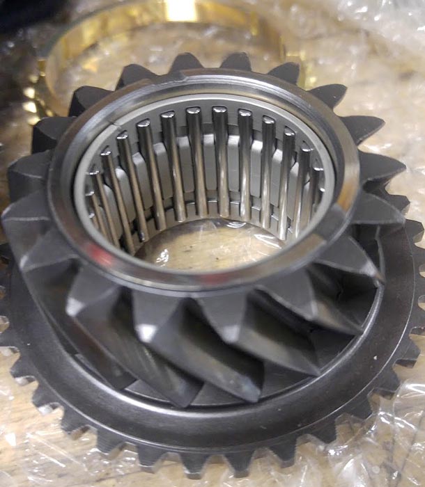

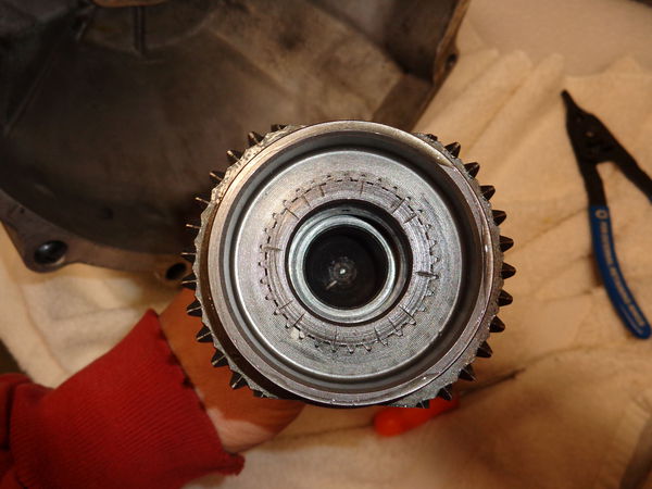

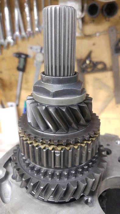

5th gear failure modes:
KM145 gearboxes (up until about 1990) had a very weak 5th gear. Because the gearbox was originally designed as a 4-speed, Mitsubishi had to make the 5th gear very small to get the desired overdrive ratio, but that didn't leave much metal to hold the gear together. Older 5th gears just broke like this:
When they revised the gearbox (changing the name to the V5M21) they increased the countershaft gear ratio to enable a larger 5th gear to be used, while reducing all the other gear ratios to keep the overall ratios the same as previous gearboxes. The 5th gear no longer split as often, but now there was another problem: the 5th gear bearing sleeve comes loose. The gearbox I'm currently rebuilding has come loose, but I've caught it just in time to be repairable.

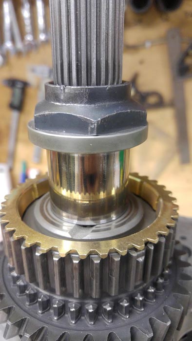

If you remove the transfer case and look inside the gearbox extension casing you'll see the retaining nut holding the thrust washer, keeping the 5th gear and bronze synchro ring against the shifter hub.:

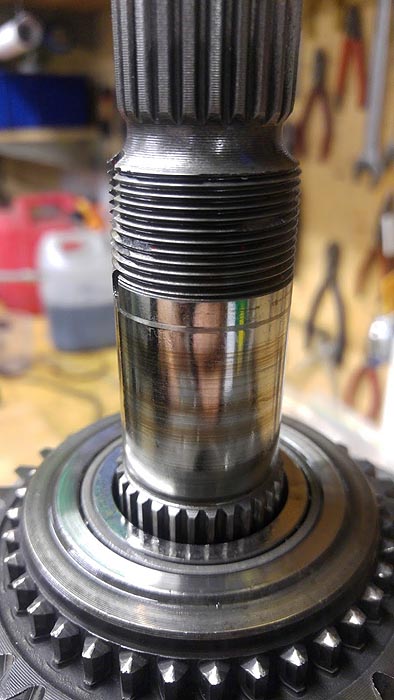

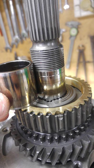

Inside the 5th gear are caged needle rollers. These let the 5th gear spin freely when it's not being used.

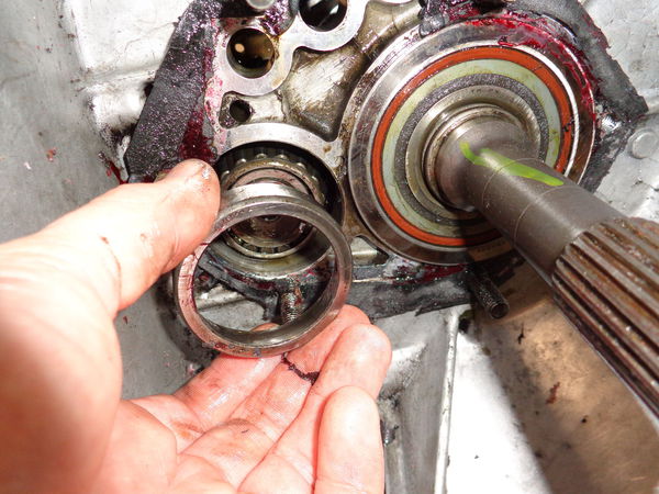

Those needle rollers run on a sleeve which is clamped in place by the big retaining nut: here's the previous assembly without the 5th gear in place.
You can see the sleeve just slips over the mainshaft so it's replaceable.

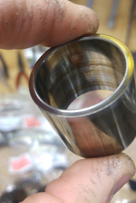

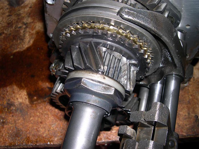

5th gear begins to fail when the retaining nut comes loose. The mainshaft twists as it transfers torque to the wheels, but the thrust washer and bearing sleeve are more rigid and don't twist as much. Eventually the retaining nut frets into the thrust washer and comes loose. Here you can *just* see the hexagonal marks where the nut has chewed into the thrust washer (I've ground both surfaces back a little before reassembly):
Once the nut is loose the bearing sleeve is no longer clamped in place, and when you're in any gear but 5th it will spin on the mainshaft (rather than staying still while the bearings rotate around it):
If the sleeve is free to spin, the needle rollers have no incentive to rotate and tend to rest in one position, brinelling (denting) the sleeve and making the sleeve spin even more.
Eventually the sleeve chews into the mainshaft, destroys the needle rollers, and breaks 5th gear. A new mainshaft is *not* cheap.

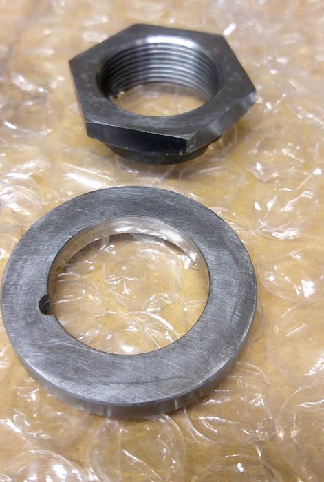

The proper way to prevent this would have been for Mitsubishi to grind a notch in the sleeve which engaged with a peg on the mainshaft, so even if the sleeve came loose it couldn't spin (like they did on the transfer case mainshaft). I guess you could add one by grinding a notch into the sleeve and mainshaft, but that would also create a stress-raiser, and I'm not brave enough to risk it. Instead I'm using retaining compound (Loctite for bearing sleeves) to glue the sleeve to the mainshaft, and regular loctite on the retaining nut.
I'll also be periodically removing the transfer case and checking that the mainshaft nut is still tight.

Morgonzo wrote:Can the nut work itself loose even if you don't use 5th? Our van has started to make a low hum/rumble from the rear end but only in 5th on the hwy. The only way to check for sure is to remove the t-case?
Yes, the nut can come loose in normal use, and is theoretically more likely to come loose while using the lower gears as there's more torque. The mainshaft twists when it transmits torque, which unscrews the threaded part of the nut, while the outer edge of the nut is held in place by the stack of bearing sleeves and gears it's clamping.
Once the nut is loose, driving in any gear *except* 5th causes damage. When you're in 5th, the 5th gear is locked to the mainshaft and so the bearing isn't turning. In any other gear the 5th gear will be turning relative to the mainshaft, which lets the bearing sleeve also turn, which chews into the mainshaft.
A noise in 5th could well be 5th gear being loose (and it's worth checking now because the consequences aren't pleasant), but it could be something else that only shows up when the engine's quiet(er) and speeds are high; U-joints, diff bearings, wheel bearings.
Even if the nut is loose, you can probably repair 5th by taking off the extension housing, saving you from having to remove the whole gearbox. You'd need a new needle roller bearing, sleeve, retaining washer, and nut. Oh and some retaining compound for the new sleeve (presuming the mainshaft isn't too far gone).

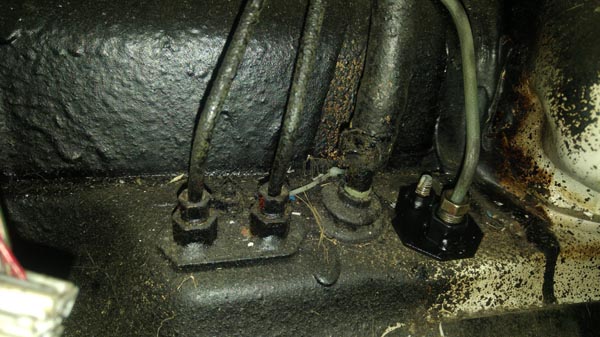

Gearbox wiring. I kept my existing automatic wiring. I had to connect the two large black wires together (black/yellow and black/white) to bypass the start inhibitor. I connected the manual gearbox's reverse switch to the blue and red/blue stripe wires. Because the manual gearbox is a bit shorter than the auto, I had to unwrap the wiring loom between the front fuel tank and the transfer case switches and re-wrap it to make it a bit shorter.

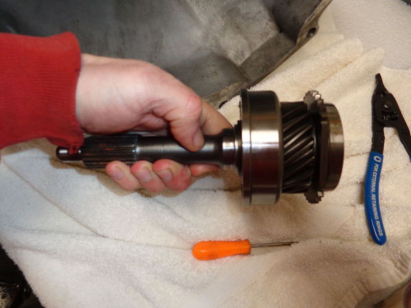

Jedidiahwiebe wrote:Does anyone know how hard it is to replace the input shaft bearing. Guys at the transmission shop told me you had to completely disassemble the tranny.
Theoretically it's possible to remove the input shaft through the front cover without disassembling the rest of the gearbox. The input shaft's drive dog ring has a couple of notches which let it move past the layshaft's 4th gear. Allegedly, if you remove the layshaft's front bearing race you can move it aside *just* enough to withdraw the input shaft.
I didn't install or remove the layshaft this way, so I can't guarantee it works, but it's worth trying first since you wouldn't need to open up any of the rest of the gearbox.
See my notes earlier in this thread about fitting the input shaft bearing with the felt seals.
