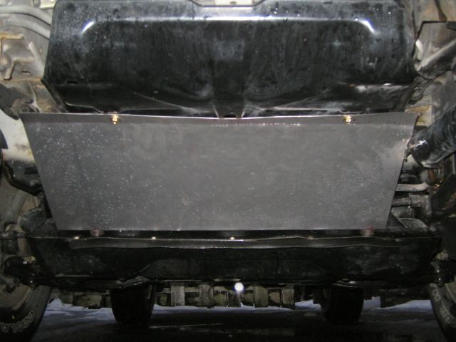

My L300 is always like that on cold days. White smoke with a touch of black for good measure. Especially below zero. It can take a few tries (make sure you have a good battery). When it fires I usually pump the pedal a few times to make sure she's good then just let her idle. I assumed this is normal for diesels. On cold day a good 10 minutes at least.
As for the engine temp: Some on this forum I think have changed their thermos, They run cold in cold weather. I've installed a windblock on my vehicle. I got a piece of thin gauge sheet metal at Home Depot (it was actually the exact measurement I needed, so no cutting req.) did some strategic bending, drilled 4 holes and one cut to fit around a frame member, and "PRESTO!" A wind block. I goes right up front above the skid pan. It blocks direct air from being forced up to the rads, and eventually into the cab, cause the 300's are draftie. It goes on in the fall when temps hit the low teens.
But in severe cold weather there is still little heat in the engine at highway speeds unless you're climbing a steep slope and running the engine hard.
