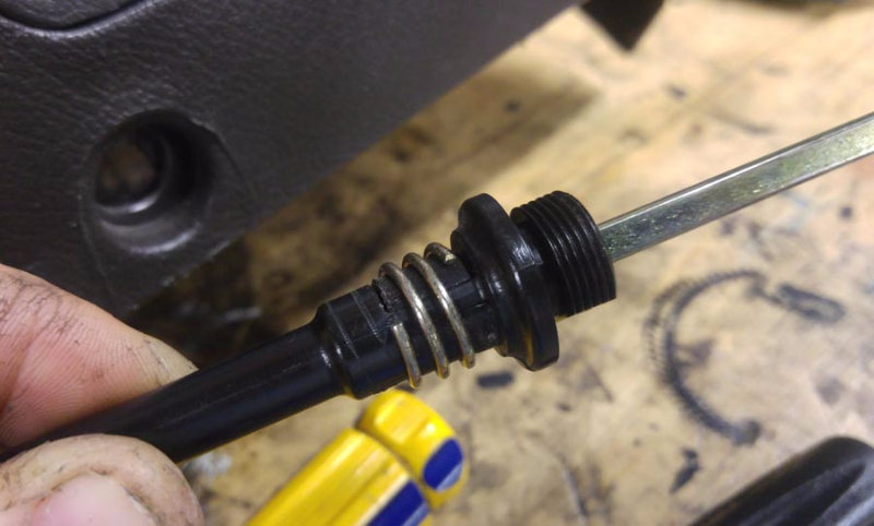

Crankshaft Culture wrote:I have the adjust knob, too. However, I think my lock is broken on it, as it does not lock. I can only actuate the throttle, not keep it in one spot.
On the body of the knob mechanism, behind the dashboard panel, there's a metal band that acts as a spring to clamp the shaft. The metal band gets weak and old- if you find a regular spring of the correct size and wind it around the metal band it'll help it clamp more firmly.
Here's one I prepared earlier:

Fixed the throttle adjuster. Turns out the collar that helps lock the throttle was loose. Super easy.
