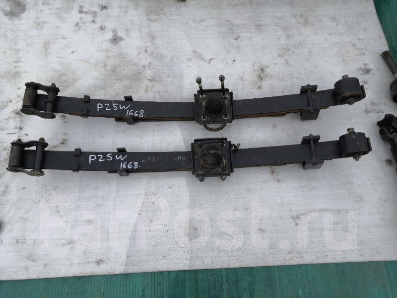

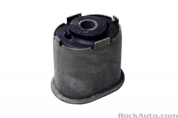

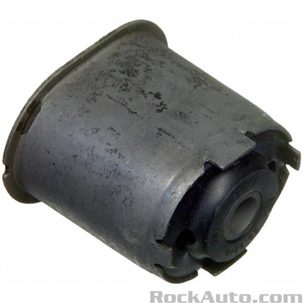

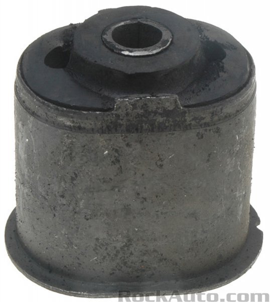

More digging has turned up these bushings on Rock Auto
https://www.rockauto.com/en/catalog/dod ... shing,7488
To compare, here are a couple of images from a Russian site (spring part number MB631472) and the Rock Auto image.

Where to get bushings? L300
Sure look similar, but that doesn't mean much... At $17 for the moog part it's certainly worth a shot. And if they fit, then the Prothane bushings would too.
I can't imagine there were that many options/makers for OEM leafs with oval eyes...

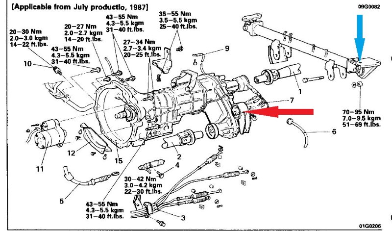

OK, so I have looked at my bushings and they be fkd.
From this thread I would need:
RHS trans mount MB581261 (NZ$117)
LHS trans mount MB581258 (NZ$118) (blue arrow)
but what are these bushings called (red arrow)
None of these show up in the AMAYAMA parts lists/diagrams...(that I can find...)
EDIT: Would these be MB58114 and MB588113 and are these the same as the engine mount bushings?
