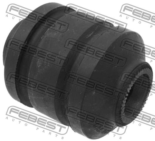

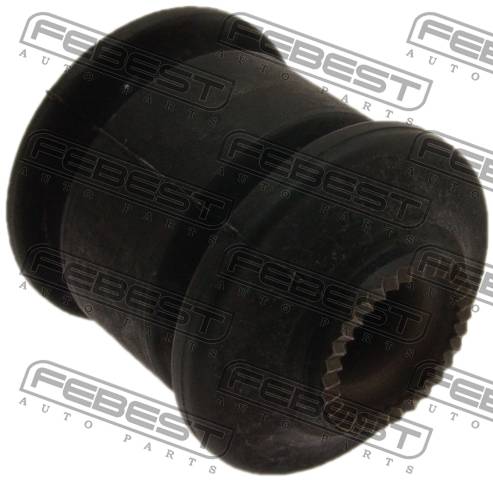

And now to confuse the issue: I'm not so sure about the bushes being wrong any more.
When I was buying replacement bushes in 2012 the dealership listed 3 part numbers, with no indication of which one(s) had been superseded. The bushes in my existing suspension arm were definitely identical, and since the dealership had only one bush in stock (and lots of them), we presumed that was the newest one and the parts book was in error (which isn't unusual).
Since we now have much better parts books online, I'm wondering if my suspension bushes had been replaced before incorrectly. Here's the parts that are currently listed as correct:
MB430960 RearBush.jpg (31.43 KiB) Viewed 13643 times
MB633070 Front Bush.jpg (28.19 KiB) Viewed 13643 times
It makes sense that the rear bush would stiffer than the front one, as the wishbone is much stronger on the rear than the front. I can't find overall dimensions. The ones I currently have fitted seem to work just fine, and haven't moved or deteriorated in 5 years, but who knows- maybe the steering under brakes would be a touch sharper if the rear bushes were stiffer? I'm not going to change them now (they were a pain to install) but next time maybe I'll buy a set of the front and rear bushes and find out if they fit properly.

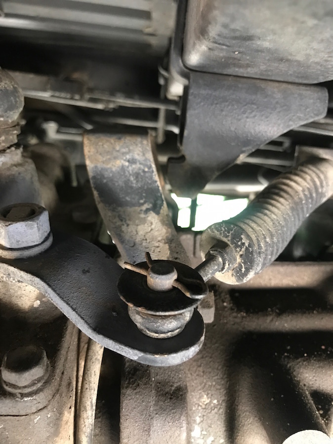

speaking of bushings, should I have on here? this is on top of the transfer case, looks like somethings missing, and the transfer case does hang lower than I would think is normal..
north54
Posts: 194
Vehicle: 1989 P35W
Where to get bushings? L300
Post by north54 »
Mr.SA wrote:speaking of bushings, should I have on here? this is on top of the transfer case, looks like somethings missing, and the transfer case does hang lower than I would think is normal..
I noticed this as well yesterday working on my exhaust. I think its more of a stop so the transmission doesn't drop to a certain level. I could be wrong.
