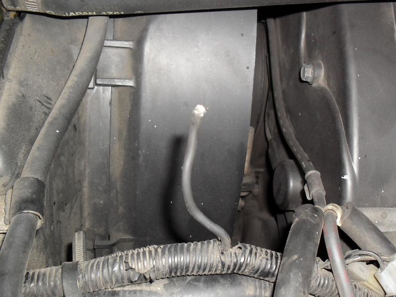

Found the little devil. Broken ground wire in engine bay. Easy fix.

Wow, how do you think that broke? Anyway, glad you figured it out, I love happy endings :-D. BTW, I moved this thread to L300 Tech.
