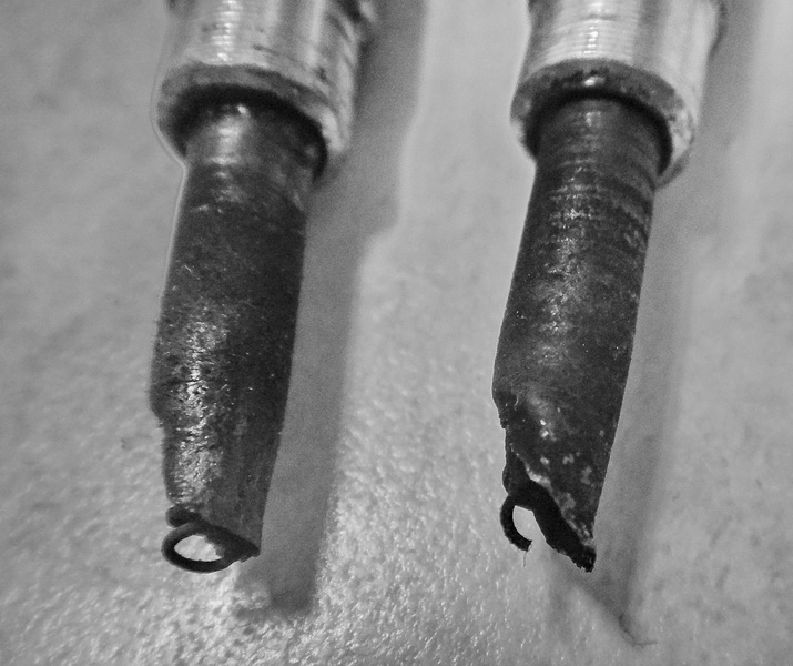

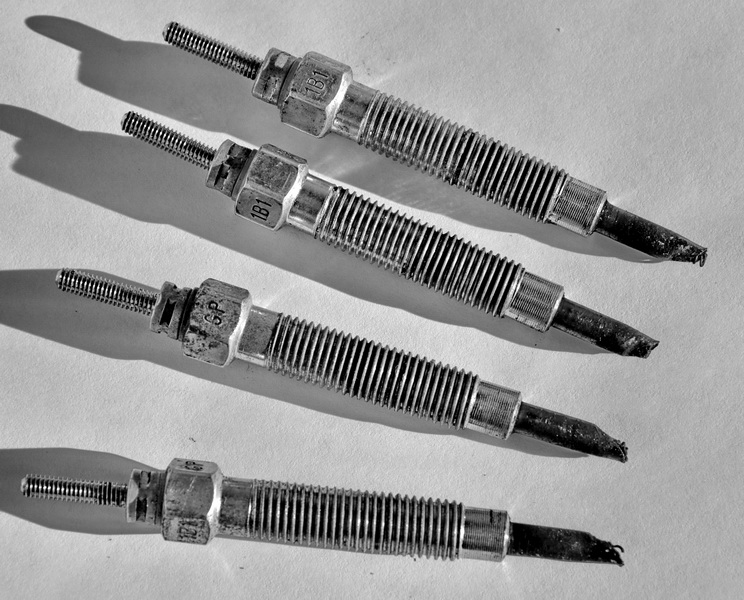

Here is how 10-month old Hyundai glow plugs look like. Installed at CVI in October 2011, replaced by myself with NGK CY55 for the same price and no labor cost. Do your math.

You have run your delica under abnormal glow plug relay system for a long time as power continuously went into glow plug.Profister wrote:Here is how 10-month old Hyundai glow plugs look like. Installed at CVI in October 2011, replaced by myself with NGK CY55 for the same price and no labor cost. Do your math.
This one could happen to all kind of glow plugs when your glow plug relay has failed , but you tried to start the van in certain period without fixing.

If his glow plug relay had failed his glow plugs would get 0 power not constant power.Rising Sun Auto Import wrote: have run your delica under abnormal glow plug relay system for a long time as power continuously went into glow plug.

You are right.psilosin wrote:If his glow plug relay had failed his glow plugs would get 0 power not constant power.Rising Sun Auto Import wrote: have run your delica under abnormal glow plug relay system for a long time as power continuously went into glow plug.
Steven
He gave power to glow plugs continuously without self control due to some other reason.
so, could be a control system problem.
We had encountered a similar issue when we serviced newly arrived L400 before selling , we decided to part out.
Steven

OK I understand what you are saying now.Rising Sun Auto Import wrote:You are right.psilosin wrote: If his glow plug relay had failed his glow plugs would get 0 power not constant power.

You have no idea what you are talking about as usual. All systems in my L400 work top notch including a glow plug one. Speculations like yours do not contribute to this thread. Stop it. I am done here.Rising Sun Auto Import wrote:He gave power to glow plugs continuously without self control due to some other reason.
so, could be a control system problem.Steven
