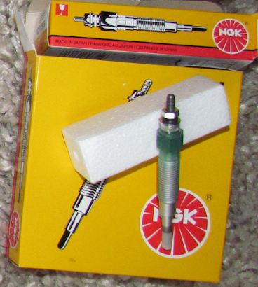

could try CCAUTOS (don't know their price) <=== they know about the good sh$%tPajero wrote:Where did you buy the NGK plugs and do you have the Part #? price?
NGK CY55, #3861
Just search for CY55 on different ebays (got mine from UK Ebay)
strikingly similar to Mitsu green tops........ (maybe even the same......
hope this helps!
