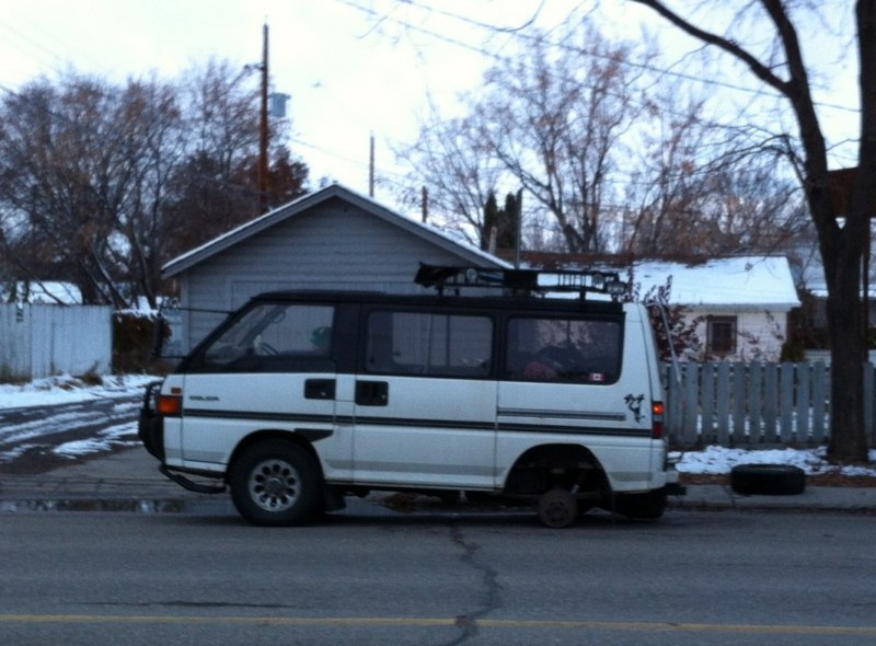

No damage except a new winter tire is trashed.
No tire shop to blame... Im honestly baffled.
I put them on, and made sure they were torqued and rechecked
later. No noise made, nothing un-to-do. At 30 km per hour the tire went zoom
and the nuts were all there within 20 ft of the center of excitement.
It was a near miss. The tire almost nailed a pedestrian.
I seriously wonder if this was someone doing something nasty.
I found everything except the center cap. If someone were to loosen
the nuts they wouldn't have been able to put the cap back on without
making noise.
The threads were all good on the nuts and bolts. I checked all the other
tires and the nuts were on good. I just don't know!

studs hitting the end of the nuts
Wrong nuts or washers
Centre bore binding rim not on bottomed

Original rims, original nuts , nothing changed. Rim on correct.
Really strange

wife took out a very large life insurance policy recently? are her hands greasy (just wondering)

Wheel nuts that are properly installed don't back off in tight groups......like ever! I worked in a tire shop for 5 years and ran the service truck to several incidents where a wheel fell off. All wheel nuts were never located and you found yours all within a short distance.
You may have been the victim of vandalism/mischief. Think about getting a set of wheel locks that have a good quality key socket like McGuard. 40.00-50.00 is a good investment to deter this kind of thing.

Agreed, mine almost came off on my way home from Whistler. If I didn't have a passenger in the rear I'm sure it would have. The only explanation was that the wheels had been loosened off while I was up the mountain. Whether it's simple vandalism, or someone trying to steal your new tires (either were a possibility for me as well) I would and did invest in some wheel locks.Big-Bird wrote:Wheel nuts that are properly installed don't back off in tight groups......like ever! I worked in a tire shop for 5 years and ran the service truck to several incidents where a wheel fell off. All wheel nuts were never located and you found yours all within a short distance.

I have seen it a few times did you clean the mounting surfaces, did you torque after 50km. Also did you lube the threads of the studs?

It's all second guessing today. I will pick up a new tire and look at some locks. It sucks the tire got a cut in the sidewall. And I got a cool picture.

I've been installing tires since I was a kid. Very meticulous. I was just at the tire shop and the 2 owners said it looked suspicious since there was no wear around the holes being aluminum. Said more often than not they wear oval from the rubbing before the tire goes suggesting the nuts weren't loose for long.
He said 99 times out of a 100 there is some damage to the rim. He suggested some locks as well
Lucky I guess in an unlucky story.
