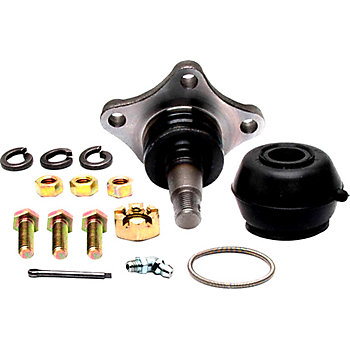

Hi,
Is the ball joint in a 1997 Space Gear/ Delica the same as in a L400? I need one for the passenger side of my Space Gear for it to pass inspection. Any info on where I could get one? The running gear and suspension on my van is supposedly identical to a Pajero, so I'm wondering if Montero parts would fit? Thanks for any information.
Cheers, Dan

Hi DanSwisstank wrote:Hi,
Cheers, Dan
This has been documented already in the L400 tech section. I posted the difference between the two.
Montero and L400 upper control arms are different = upper balljoints are different = not interchangeable
As for Paul's reference to the Series I vs. Series II drivetrain goes, both are identical. This as well has been documented in the L400 tech section.
With regards to the lower balljoint, you 'can' use a montero/pajero with a mild modification if you absolutely must. Modification required : The grease nipple has to be removed and sealed shut as it is located in a position on the balljoint casing that rubs up against the inner lower control arm bracket making the install a near impossibility.
Jesse
*edit* I've posted pictures of the two so you can see the difference
