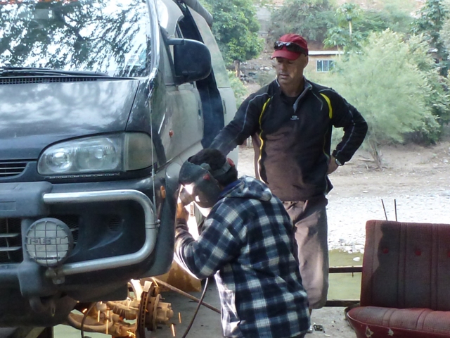

I have now broken TWO upper A-Arm out of the front suspension. In both cases, the upper ball joint (bolted on with three nuts) have pulled clean OUT of the upper A-Arm. What the hell?
Thankfully, 5 dollar welding is possible in Mexico! Although the whole setup and process was truly sketchy to watch.
Any one ever have this problem before?

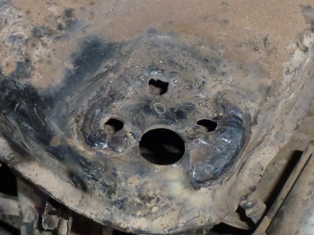

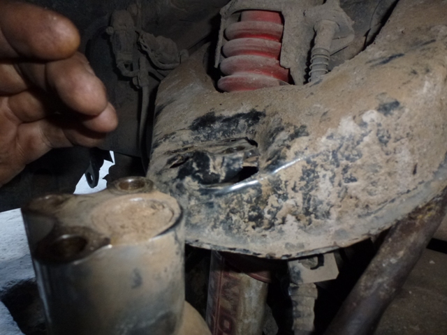

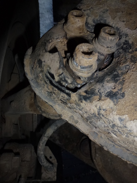

Not sure what is going on Jesse - Since I broke and later replaced the RIGHT upper A arm in Utah, I have been diligent to regularly check that the bolts are tight and not having any wobble and stresses on the A Arm.
I am interested if others have had similar problems or if, like psilosin, I got a dummy L400.
Here you go LEFT side L400:

Re: L400 Upper A-arm problem
you problem is evident in the 2nd picture
that balljoint spacer is WAY too tall to be in there. the stress is causing the balljoint to knuckle/turn over and put stress on the bolts.
Funny I just helped another person with this same problem. 1" maximum spacer on TOP of the balljoint. Anything more and it will kill the suspension parts.
Whoever did your lift did a great job on the rear but the front end the way it's shown is not meant to go offroad, just for show. Have that spacer cut down to .9 inches and reinstall with new grade 8 bolts and reinforce the a-arm with an additional 1/16" steel plate (drill fresh holes for the balljoint bolts).
The way it is it will break through again and it can be dangerous. Good luck and I hope the repair will last. (good karma going your way).
