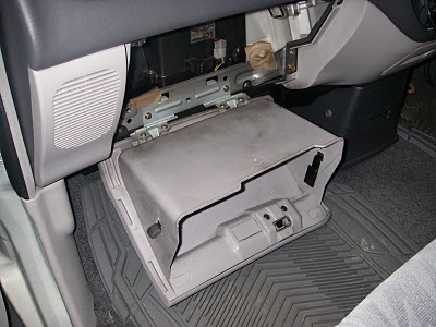

Push the side clips into the glove box and lower it. You can see up to the right behind the heater control box.

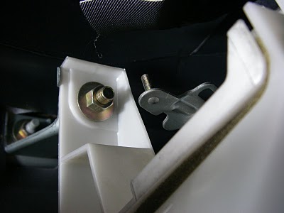

You will see this pin. It will have a cable on it. It controls the hot/cold.

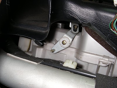

From the front you can see this pin. It controls the fresh air on the face blue arrow thing. The cable has been removed here too.

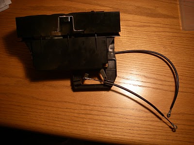

Take the two cables off the pins. They are also secured by a clip near the loop. Remove the four screws on the front of the control unit. Unplug the two electrical connectors. The box will pull out. Note the loops visible on the two cables.

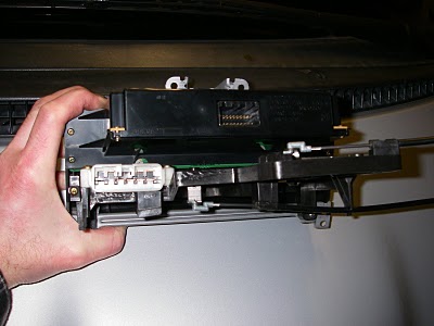

The back of the control box. Remove the four screws on the part covering the electronics.

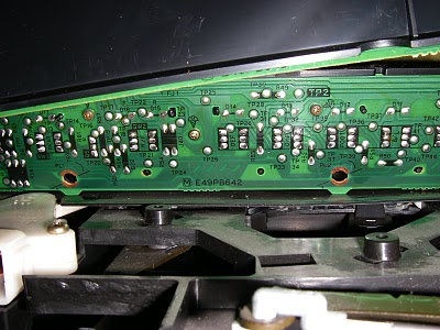

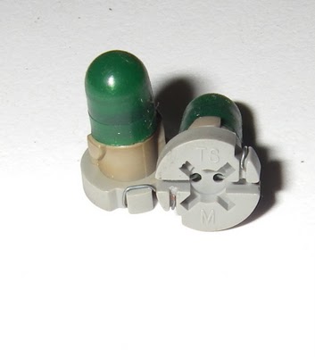

The circuit board revealed. The two holes at the bottom house the bulbs, The bulbs twist out.
The bulbs featuring green rubber covers.
Thank you jfarsang!

No idea where to get the bulbs. Thanks for the photo of the bulbs. Very odd size and shape indeed. I was hoping to get a replacement at Canadian Tire but this looks like a more specialized bulb.

The green covers come off the bulbs and the bulbs come out of the grey bases. You need those bases. I went to an electronics supply shop today with the base and got bulbs for $1.25 each. The originals are 12 volt, 4 mm wide (at the top of the bulb - the base is narrower), 9 mm long not including the wire tails. I couldn't get an exact replacement in town so I went a bit smaller with something called an L22 bulb. Installed them tonight and it's pretty much changed my life. I didn't use the green covers because the smaller bulbs aren't as bright. Get the bulb that is closest to these dimensions. If you go too big the bulb won't fit in the base or the hole.
