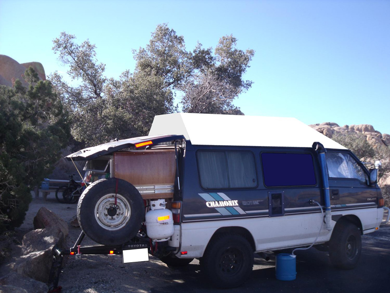

Sleeping will still be in the slide unless some kids get given to us soon (they might but that is another post). In reality most trips will be local for the next little while.
The wind in Joshua Tree gusting over 50mph made me think hightop. The west camp near us looked like the wind was hard on the back hinge.

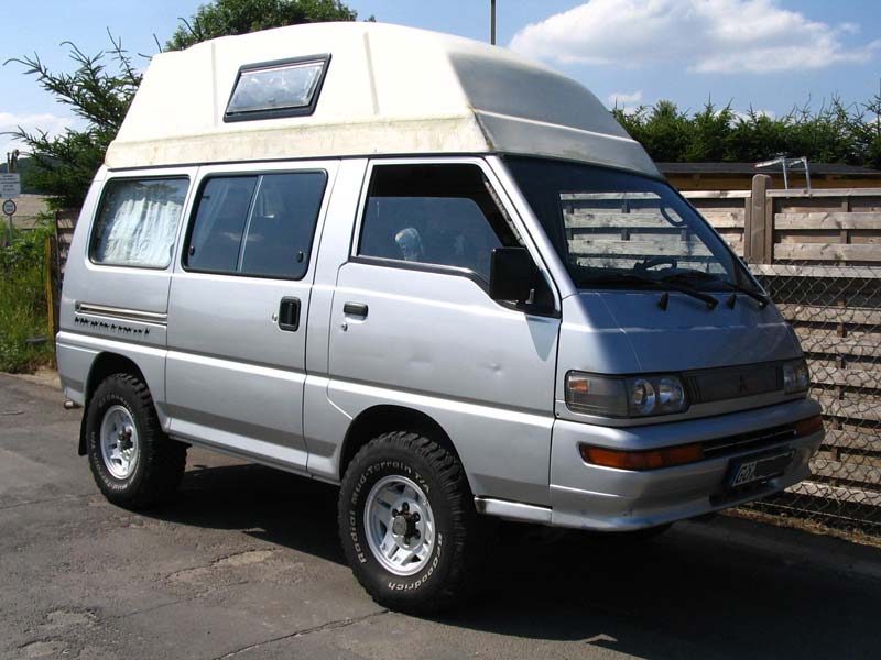

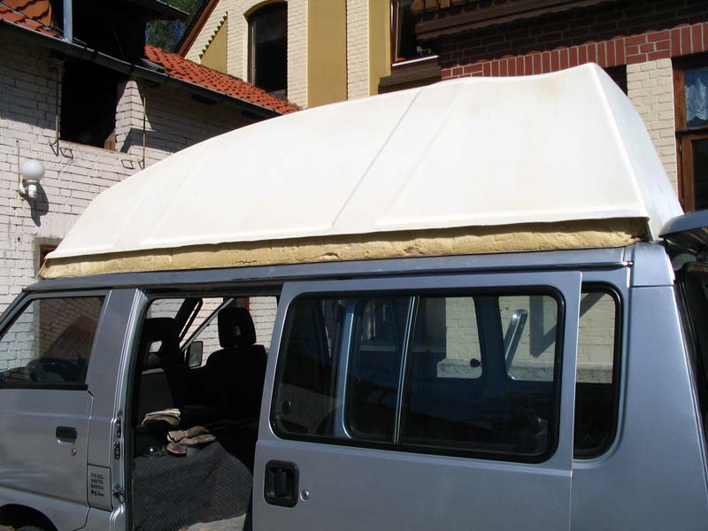

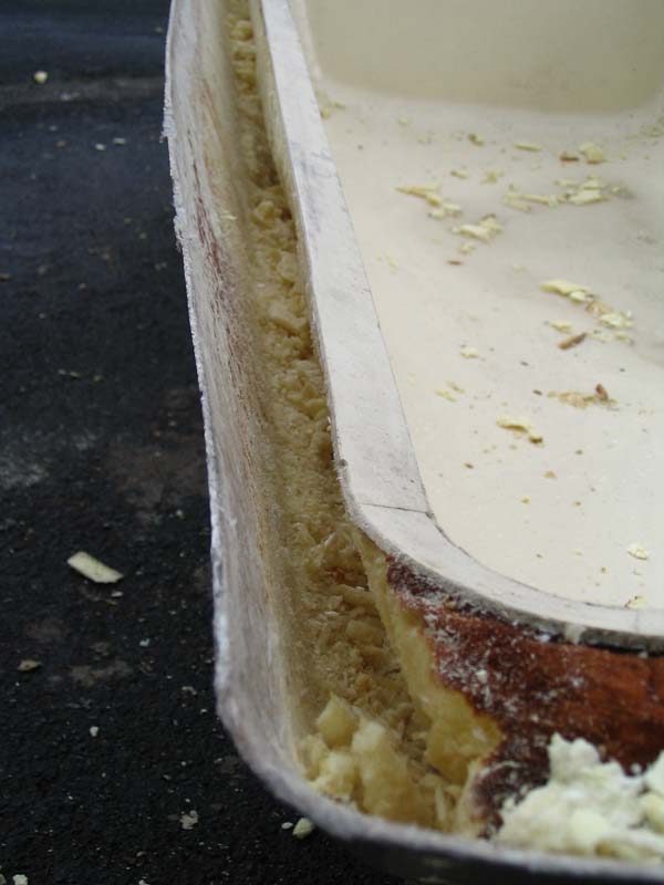

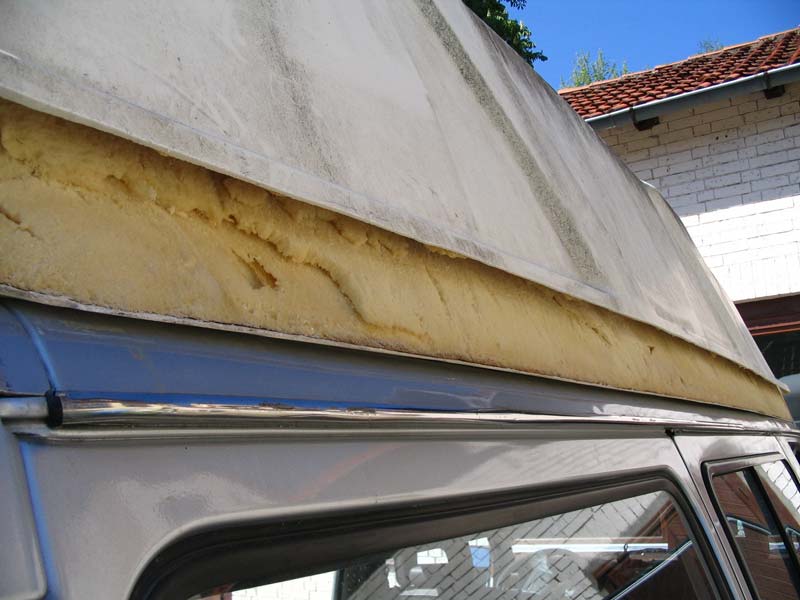

Re: Vote for Hitop VS Poptop
Some inspiration photos for you...
- 4.jpg (40.22 KiB) Viewed 6337 times
- 3.jpg (54.93 KiB) Viewed 6337 times
- 2.jpg (55.16 KiB) Viewed 6337 times
- 1.jpg (66.26 KiB) Viewed 6337 times

Thanks for the Photo! Do you have the source for it? I would like to see how they cut the stock roof (I have been looking at UK poptop tent conversion).
Is that the same one as this one? I cannot find any still photos of this one:
2 things...1) HighTop looks surprisingly rad on the L300...very Euro VW Syncro'ish, and 2) the Toyota alloy rims look perfect on that L300.
