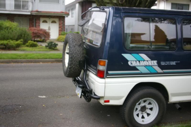

Old FJ40s have 16" steel rims, I run them on my L300 fit no problem (mine not for sale).

They have 108 centers and are not split rims. Standard wagon wheels. Think it was a 1976 FJ40 (had drums prior to going to 38" tires, friend owns it).
here is a photo:
here is a photo:
