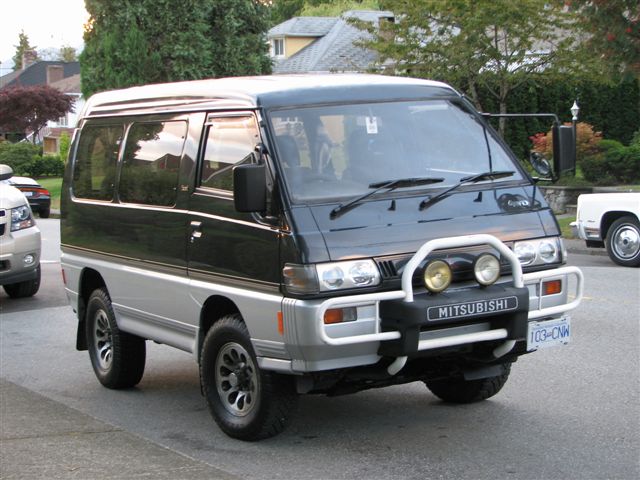

Well....Josh was right - the sway bar bushings (I think it's a sway bar anyway???) - were dried up as old prunes and virtually falling out altogether. Went with the Energy Suspension 98101R from Lordco (the red ones per Mardydelica...many tks!) and all is right in the world. Driving as smooth as can be! Took no time at all - so took off the step bar on either side while I was down there - think it looks better without them - understand they're intended to protect the various coolers down there...but don't expect that to be a problem given the kind of driving I will be doing. Feels great to be poking around down there - a few more to change soon just for good order. Tks for all!
- Aug_2007_071.jpg (71.15 KiB) Viewed 8532 times
