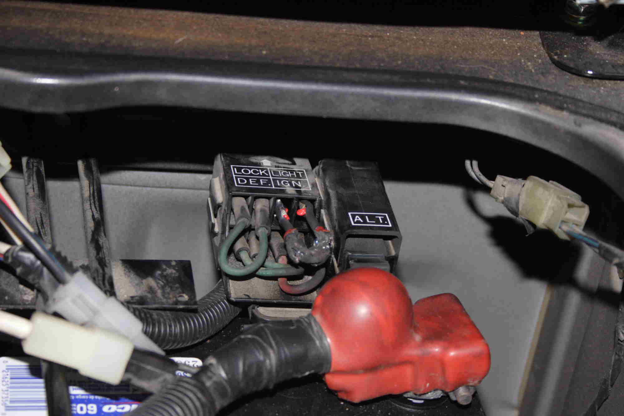

so i start rummaging around under the seat and notice that one of the wires that comes out of the four wire box that is connected to the 100 Amp alt fuse. thingy off the postive battery terminal is comepletely burnt through!
sooooo. I fixed that, and everything worked, Drove for a while 20Kms about.
and all of a sudden battery light flickers a few times and then all, lights and radio blows again.
drive back to my house, check under the seat and the same wire is totally charred. Again.

heres a pic, Im thinking it must be the headlights shorting somewhere, they would maybe be the only thing drawing enough current to zap that wire.

or it could be a short at the alternator.
the wires pass over the frame and were worn right through, check em and tape em boys.
that will save you some hassle in the future!

got is figured, was grounding out against the frame.
Driving around on the third world highway, wore right through some wires.

Re: Electrical Mayhem!
