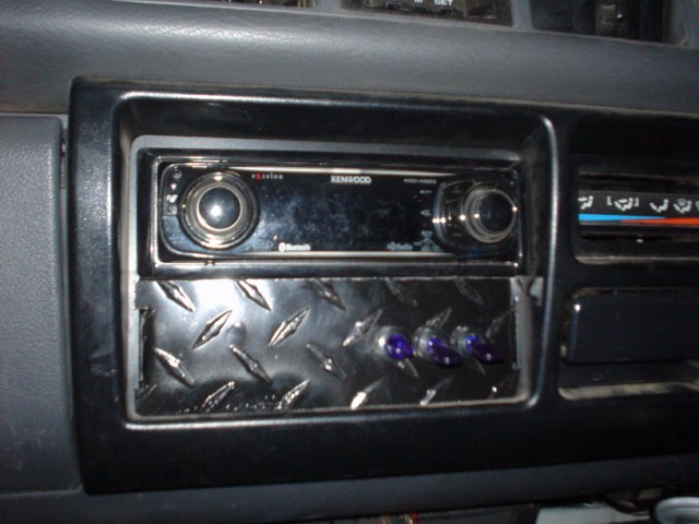

I took an hour at lunch today and put new H4 sockets on the wiring removing
the old wire and connection. I also totally removed the old negative wiring from
the mix and put new grounds for the 4 bulbs right to the chassis.
I still get the ghost of a light in the center hi ones. Still not worried about that.
Included a picture of some switches.. they look better without the glare of the
flash
FS

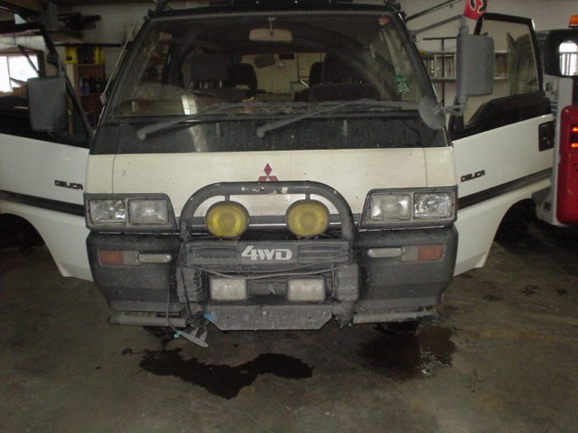

Re: Headlight wiring mod
My van is really dirty.. kinda embarrassed to show a picture of it right now ;)
- Firesong
- Posts: 1363
- Location: Saskatoon
Ok, here's the dirt.. right between the Bobcat and the Kubota...
FS
FS
- Dirty.JPG (65.1 KiB) Viewed 2442 times

Hey Rich
I think the hole is the same. You just need to source a set.
Mine has the squares and I love them except I have to wear sunglasses at night!
I can bring my van over but I am sure they will work.
David
David

I think I remember reading that the front is different.
You can't just get the molding and put in the lights.
I was considering initially of going the other way and
that's what I found out.
Unless you don't mind doing some body work.
