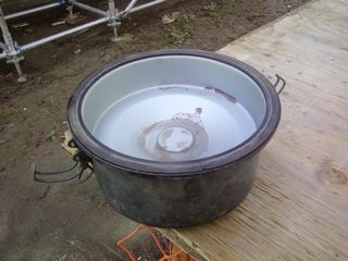

It makes a pretty loud rattle at idle. Rattle goes away around 1300 rpm. It's louder with the door closed. I took it in (from where I got it) and we replaced the bottom portion with another one out of another Delica. We thought that worked. But it came back the very next day. We thought it was a gone'er, but it just wouldn't stay away!
So I got in there and cleaned it out, took out the filter etc. It was very clean. So I put it back together and put it back in. And it was still noisy.
Anyone else have/had this problem?

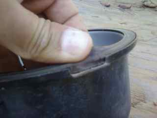

I wonder if the problem might be the rubber gasket between the two assemblies. It looked a little dry, flat and had a couple small, small cracks. Does anyone know where to get such a gasket? If I had a little more cushion between there, it might do the job. Anyhow, that's what my ears are telling me. Thoughts?

Do you have any pic's of the gasket? Depending on the configuration you could make a new one yourself.

Thanks. I'll go have a look after the rain stops. I hope it is that simple of a fix. I'll still take a picture of the gasket, I'm curious if that would also help. Have also considered putting a rubber washer on the bottom of the filter, too. I'll let you know what happens.

I took the bottom part of the air cleaner off and started the van up. The rattle was gone. I put the bottom part back in and the rattle came back. So, I am pretty sure that this piece is the culprit and that the gasket you see there is a little too worn causing the rattle sound. (of course, I could be wrong). Is there a replacement part for this gasket, or does someone have any good ideas as to how I could jimmy one up?

Try some of that foam weather stripping for around exterior doors and windows?

Bend the clamps so more pressure holding it closed (add 2 more clamps (find them at wreckers?)
