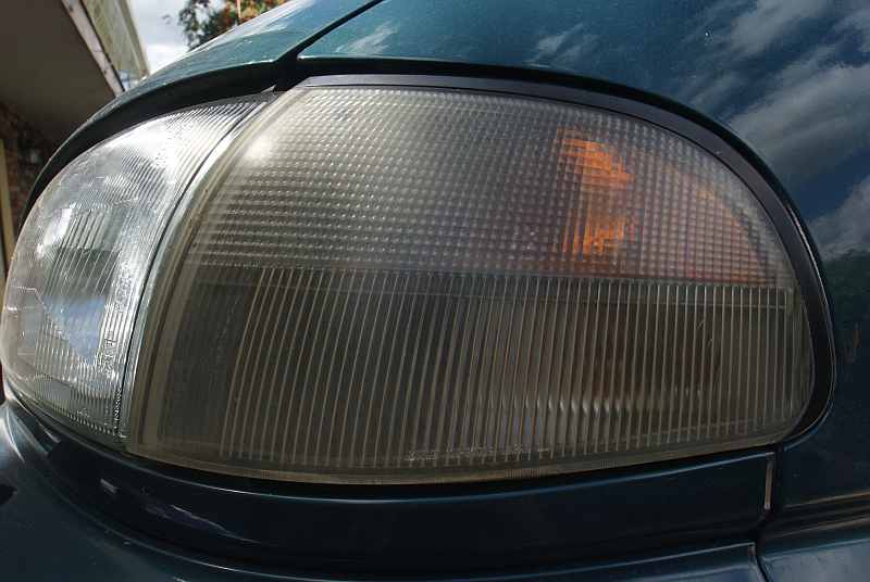

Meguiar's comes with a drill buffing pad, and that makes all the difference in the world:
Before
Before Polishing
Before Polishing

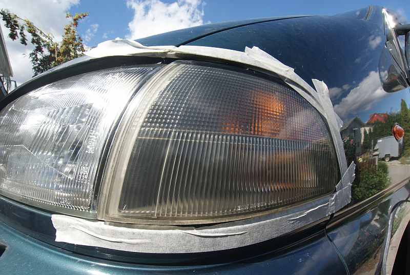

And, after Polishing (with masking tape still on bodywork to prevent the paint from being polished off):
After Polish
After Polish
Unfortunately the sun moved while I was taking photos, so the after photo is more brightly lit. Sorry about that.
You can actually see into the lens now from a distance, and it looks much clearer, so there will be no need to replace my signals. However, there is still a yellow tint to the plastic, but this comes from inside the lens where I can't polish the yellow out. It is not as severe as the yellowing was on the exterior however.
