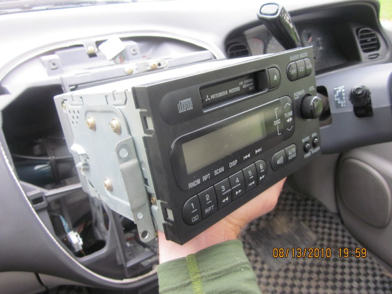

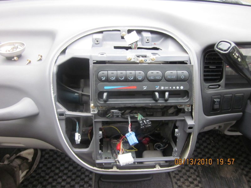

Last evening I removed the front bezel so that I could have a look at the stereo connectors and how the current unit was physically mounted. I followed JFarsang's directions here. You'll see what I found in the following attachments.

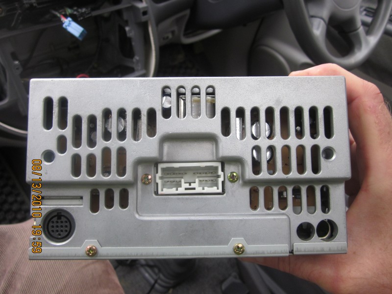

- The business end of the stereo.
- current_stereo_rear.JPG (128.44 KiB) Viewed 4636 times
- The current stereo. Check out the cassette player!
- current_stereo.JPG (123.9 KiB) Viewed 4636 times

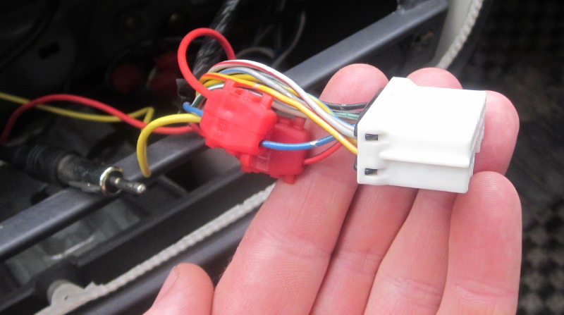

- Looks pretty standard, but what would it be called in a parts catalog?
- stereo_connector_front.JPG (82.8 KiB) Viewed 4636 times
- Is this stock? Those red plastic clips make me wonder.
- stereo_connector.JPG (85.95 KiB) Viewed 4636 times
- The bezel is removed (without being cracked).
- bezel_removed.JPG (121.85 KiB) Viewed 4636 times

So Mr. Fibble's mentioning of the Road King 7 from ChinaVasion got me thinking. I priced out the components for a car PC and it starts to get stupid when you add things that you don't normally see on computers, like radios. Touch-screens aren't cheap either. Although I haven't fallen off the fence yet, my guess is that I'll order a RK7 myself...probably tomorrow. My intention would be to get Linux running on it, but a lot of my intentions never become reality. Would it ever be nice to be able to throw a wireless USB dongle on that unit and be able to transfer stuff to/from it over my home/work wireless networks. Success getting Linux running on some affordable random bit of Chinese hardware would get me huge geek points. Huge! But I'll return from The Land of Nerds now.
I took some time to explore the Delica tonight. Started with simple stuff like: Where are the cylinders on this thing? How about the glow plugs? Oil pan? Oil filter? I managed to find everything but the injection pump. At least, I'm not sure that what I was looking at was the injection pump. Its amazing what reading about diesel engines, turbos, and intercoolers on Wikipedia can teach a fellow.
Back to the audio system. I decided to rip out the CD changer. The stock system will confuse me enough without after-market bits thrown into the mix. And it's not like I would use the thing anyway. It was fun following the wires back to the stereo from beneath the passenger-side chair: Under the carpet, along the passenger-side door, across the passenger-side foot-well, to what looked like a small amp in the foot-well, and then up the "neck" below the stereo and air controls. That's where I got stuck. I couldn't get the plastic cover on the neck off, at least not before it was getting dark enough that wisdom kicked in and I decided to rip out what I could (without cutting wires) and put everything back together.
I'm now sure that those red clips on the stereo connector are there to confound me... or just to connect the CD changer to power. I've seen similar stuff. They'll be easy to remove, hopefully putting the van back in its stock configuration.

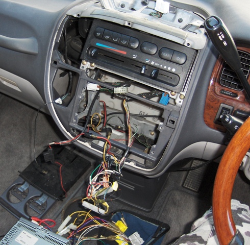

I will be starting an L400 stereo thread next week; doing a complete install; stereo, amps, subs (under rear bench) all speakers, dual battery with isolator and override switch..... blah blah.

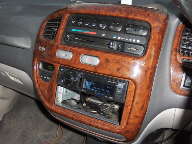

Just got stereo head unit in couple nights ago. (finally a radio!)
I will try to include pics of all re-re; trying to highlight the tricks/quirks of the panels.
As for the head unit, just what I did...... I specifally went to a single DIN, and will utilize the remaining space to mount EGT monitor, battery bypass (duals), glow plug indicator lights etc........pics in other thread when complete. (will be slow
) As for other features, you have to decide what you are looking for. Myself I wanted excellent THD, high pre-out voltage, aux input and usb input, bluetooth with wired mic, 3 pre-outs.....

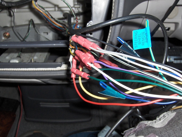

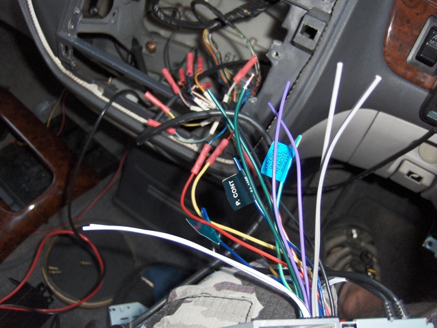

stereo will come with wiring harness, get some cutters (snippity snip the old connector off delica), meter wires (constant 12+, acc 12+, light dim 12+, and pair off speakers from there) actually I can probably take the time next time I have head unit out, and spit out all the wire colours and such. Get some "red" butt connectors and crimp in the stereos harness (properr way if can not get adaptor). Will post pics and wire colours next week.Rural wrote:which harness to mate the unit to the Delica
- 1.JPG (137.84 KiB) Viewed 4495 times
- 2.JPG (143.74 KiB) Viewed 4494 times
- 3.JPG (141.69 KiB) Viewed 4494 times
- 4.JPG (156.09 KiB) Viewed 4492 times
