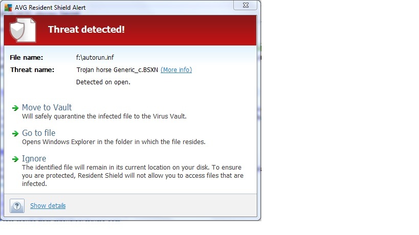

Oh, and being a Chinese unit I got what you would expect the moment I put the 2 GB SD card from the unit for the GPS software on my laptop....
